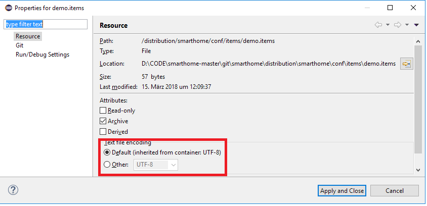

Josar
(Josar)
March 20, 2018, 12:00am
6
For me it works out of the box.
Seems your file encoding is not right.
In Eclipse select the file right click and choose the last option Properties. The file encoding should be listed there.
Did you create the file in eclipse? It should ussually create all files as UTF-8.
You can also use notepad++, it shows the file encoding in the bottom area.
