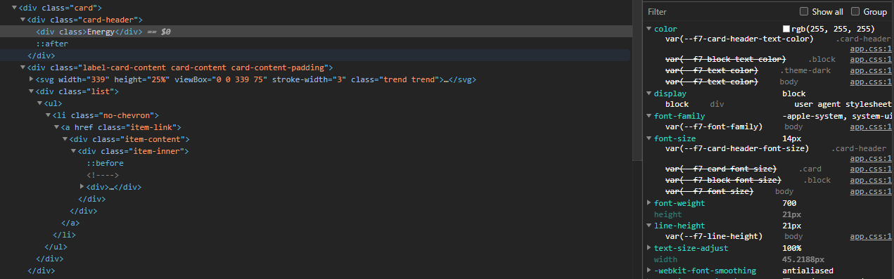

Also you can use the “inspect” feature of your browser and go to the Computed pane where you’ll be shown how the style property are set and what caused them to have that particular value.
Many of them will come from one of the –f7-* CSS variables, in this case you’re lucky because all you have to do is redefine it somewhere above in the tree (like your f7-card) and they will be inherited to the descendants.
style:
  --f7-card-header-text-color: red;
  --f7-card-header-font-size: 24px;
