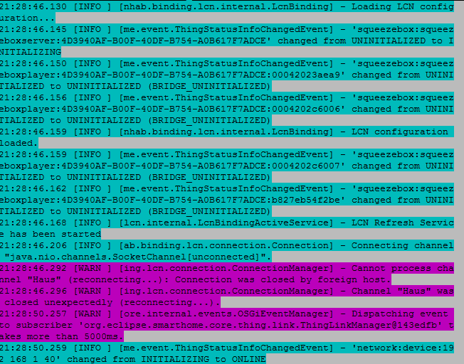

When i look in the log file with Karaf console i get the following after startup Openhab from the log file …see picture also
Connection closed by foreign host…
i see the items from the sidemap on the IOS client. If i switch an item on the Handy the status changes in the App but in real nothing happens.
Any ideas please ?
Solved the problem
i set the logging level of the LCN binding to debug with Karaf console
Then i could see additional messages : wrong passsord or user…> so there is something wrong with user and password authentification beetween LCN config file and PCHK service which is running on my Raspi.
Thats the reason where the connection will be closed.
