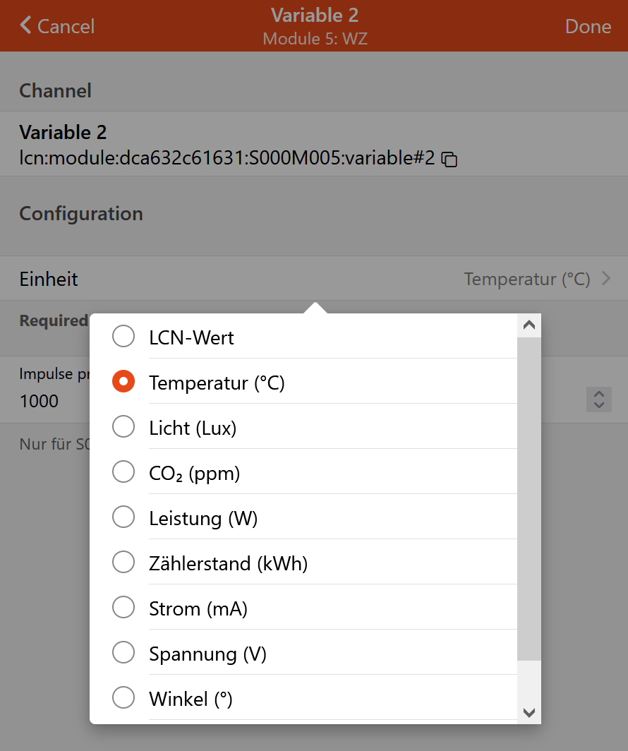

You can select the unit in the Channel configuration. Go to the Thing’s Channel tab and click on “Configure Channel” at the setpoint Channel.

Great! It works. very, very simple… :slight_smile:
