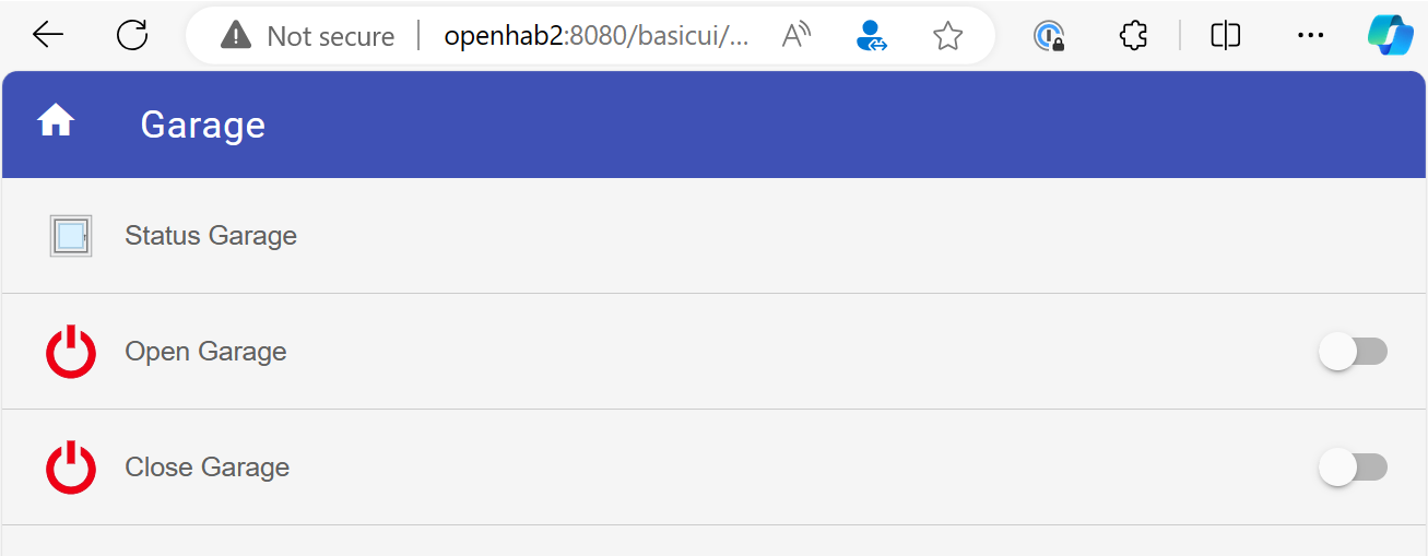

And on OH2 everything works as expected through the Basic UI:

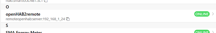

Q2: Is the Bridge Thing created?
Q3: Is the bridge showing as ONLINE?
A2 and A3: Yes and Yes (OH4):
And openHAB2remote is working perfectly for another Thing.

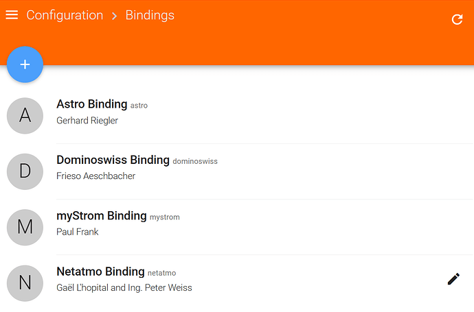

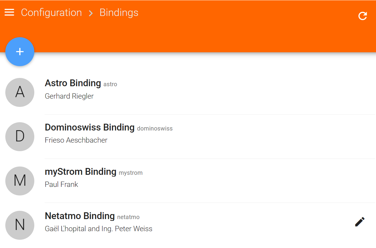

Q4: Do you have the Things representing the Items in the OH 2 instance?
A5: No. There’s no Piface-Thing listed on OH2, even though that the binding is also visible as installed PaperUI:
However its’ not listed under “Bindings” (?):
