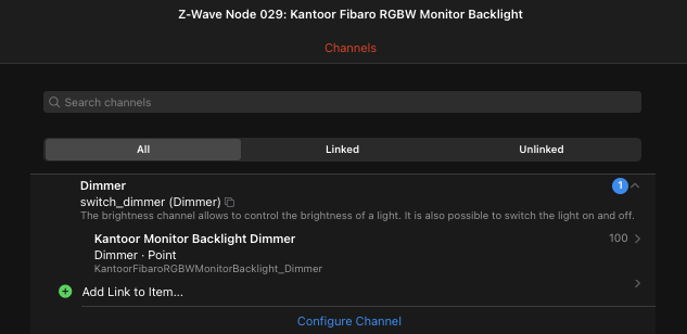

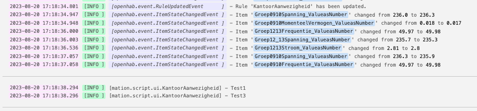

The value of item “KantoorFibaroRGBWMonitorBacklight_Dimmer” is set to 100:

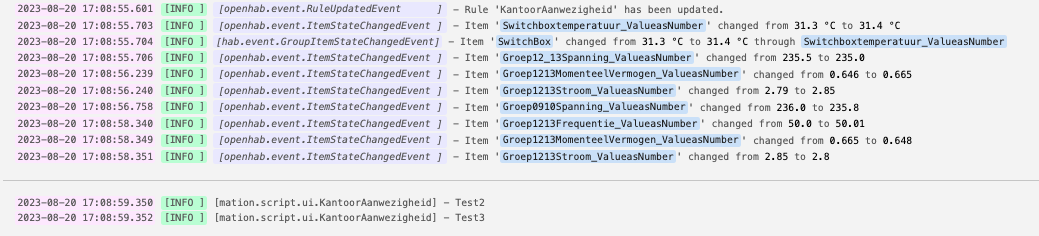

When i execute the script i would expect to see in my Log Viewer info text “Test1” and “Test3”, for value 100 (KantoorFibaroRGBWMonitorBacklight_Dimmer) is greater than 80.
Insteat i see the following result:

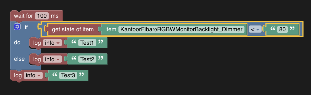

So i changed the test rule in:

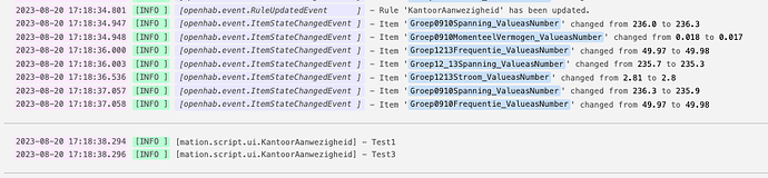

When i execute the script again i would expect to see in my Log Viewer info text “Test2” and “Test3”, for value 100 (KantoorFibaroRGBWMonitorBacklight_Dimmer) is still greater than 80.
I did some more testing with other items, but all the same (inverted) results.

For now i “inverted” the comparison symbols in blockly, and the rules seem to work.

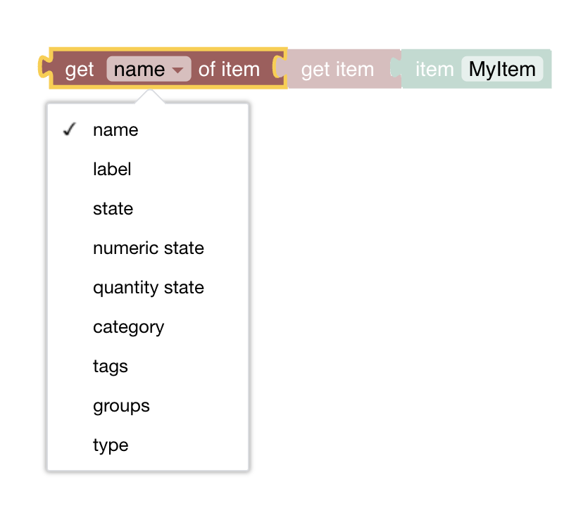

In order to do the comparison you want, you need to be working with numbers. You want the
block and to set that dropdown to numeric state. Then you can set up a comparison between that number and the number 80.
Which will give you the proper code comparison:
items.getItem('MyItem').numericState < 80;

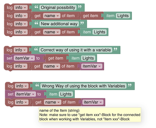

I second the fact that I don’t like that either. I actually implemented much more resilience towards that, so you add either one of the blocks (getItem) and omit the other one. For some reason I must have failed there and created other side effects or regressions.

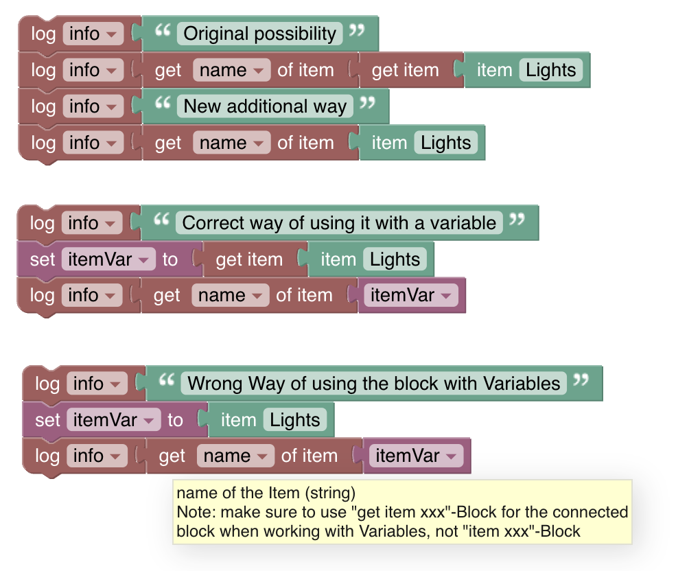

I added this functionality now and I hope it will not create a new regression.
The block can now take both “get item item xxx” or (new) “item xxx” directly. I have also added some hint in the help tooltip that clarifies how to work with the block when using it through variables because Blockly has to make an assumption due to the mentioned fact that it cannot detect what is provided in the variable.
I hope that helps!
