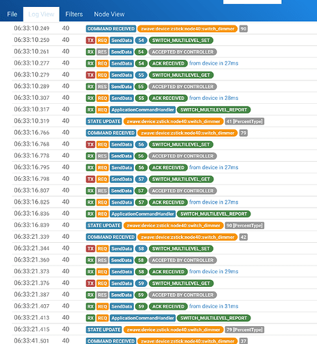

The device included successfully, and works as expected with one exception. When sending the command to set the dimmer level, the binding sends the SWITCH_MULTILEVEL_SET and then immediately sends the SWITCH_MULTILEVEL_GET. The problem is that the SWITCH_MULTILEVEL_REPORT that comes back in response to the GET is the original dimmer value before the device has applied the value in the SET.
What I think is happening is that the device is processing the GET before it has finished ramping up/down to the dimmer level in the SET command. Here’s a snippet from the log viewer that shows the behavior.

This situation doesn’t involve an unsolicited report. The report in in response to the GET, which is sent around 50 ms after the SET is sent – definitely not enough time for the device to ramp to the new level.
