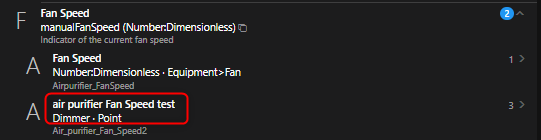

Edit: @michikrug thank you for the time you invested in this already. Smallish update, i did managed to advance a bit:
I created a new “fan speed” dimmer item in the fan speed channel:
The binding does not react to the dimmer item. Whatever value I put there it resets back to what the first item of the picture is set to.
But if I change the dimmer to Number:Dimensionless then it picks the value up.
If I switch from dimmer to a number:dimensionless, Google Home no longer picks up the device at all. No matter how many times I sync, it simply doesn’t pop up.
Switch from number to switch and it pops up as a relay, no speed control.
Switch to dimmer again, and it also pops up in google home, with speed control.
Switch to Number:dimensionless, nothing on openhab (commands don’t work) and on google home no dice.
Now, I thought about the rule I created (using the % values) and I edited it with your suggested command:
“0=OFF:zero,1=low:one,2=medium:two,3=high:three,4=turbo:four”
This works! This simple change simplified my conversion rule! - but I still need a dimmer item to receive the commands from google home, and then to forward it to the item of the binding channel because:
A number:dimensionless airpurifier metadata item is not picked up by google home at all.
A dimmer item in the channel does not work with the thing.
A switch does not offer the speed control function I want.
So, still kinda stuck, but at least things are working as I expect them to work.

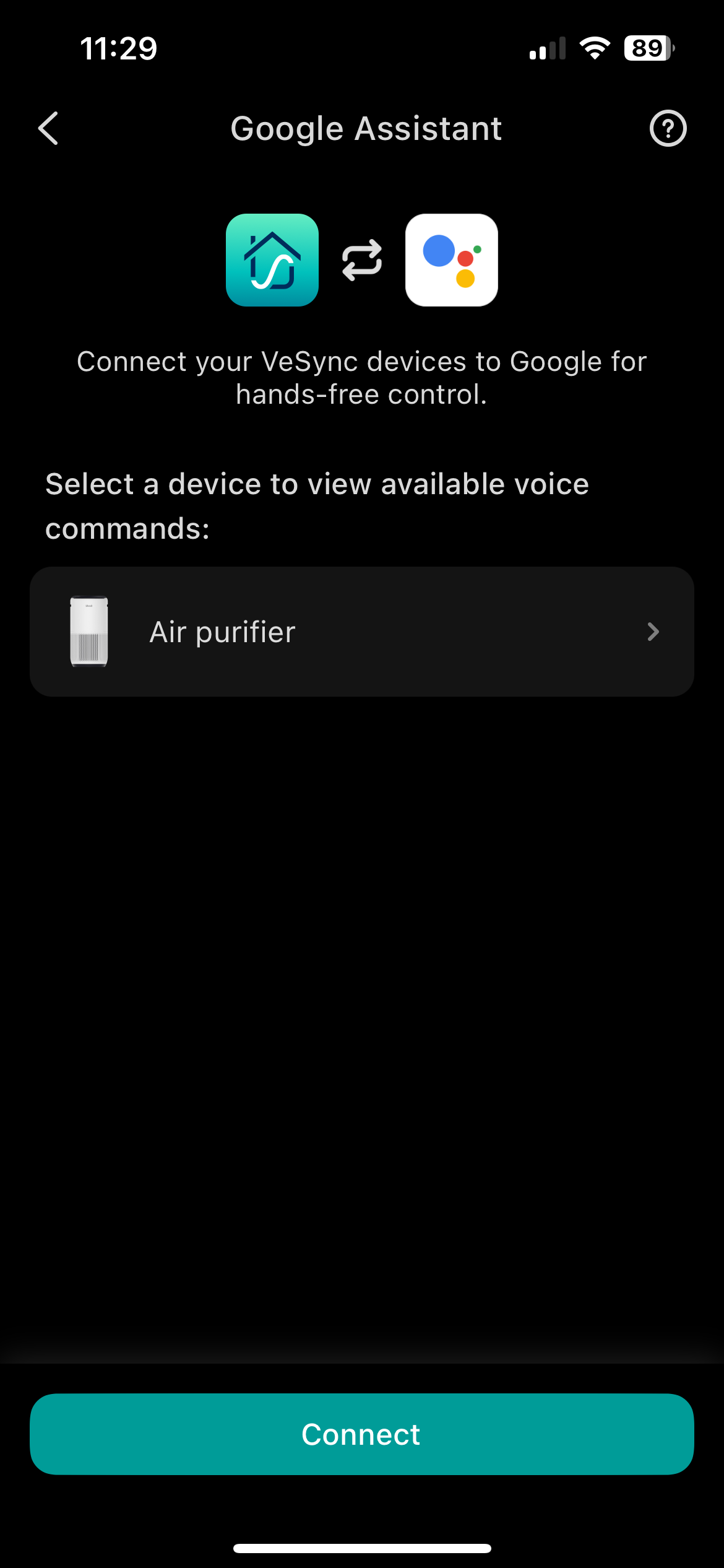

is Levoit not compatible with Google Home directly ? This says that using the Vesync app ,i can link my google account and vesync and automate my Levoit Purifier.
Or should i opt for Openhab ? Does that enable more automation options ?
It’s up to you.
From my screenshot I can deduce that I can link levoit app to Google home. But not everything is exposed. I have it through OpenHAB. Why not try both and decide for yourself?
