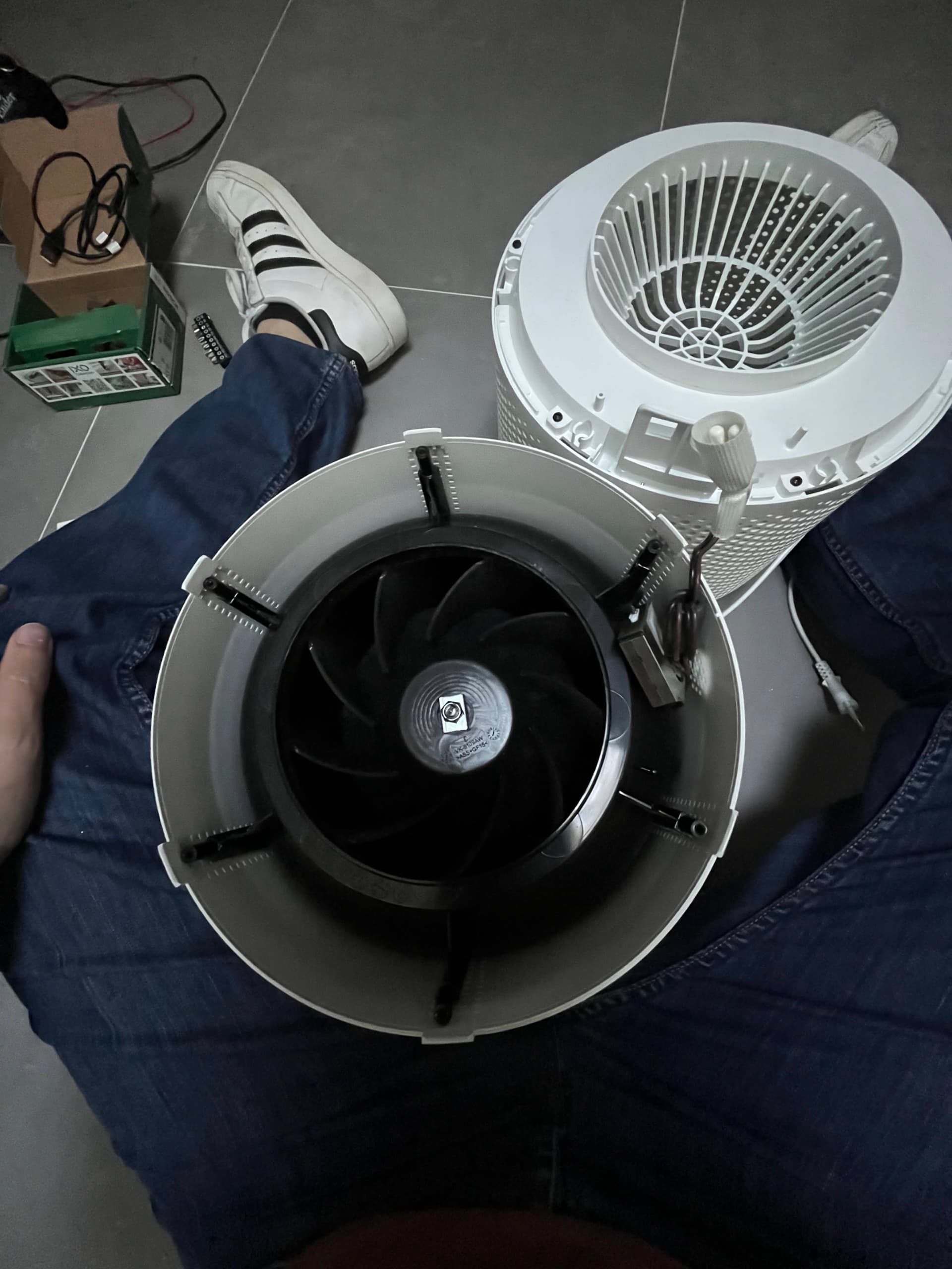

Don’t judge, I had no idea I could also go from the top to get to the board…
If you use a plastic spudger, you can get the top part of the purifier out easily, where the main board with the esp32 is. The plastic rim is stuck in place with plastic clips, which is terrible because I broke them all, but on the other hand now it’s quite easy to remove the stuff my one year old sticks inside of the purifier. So yay?
So really, you don’t need to do all I did there.

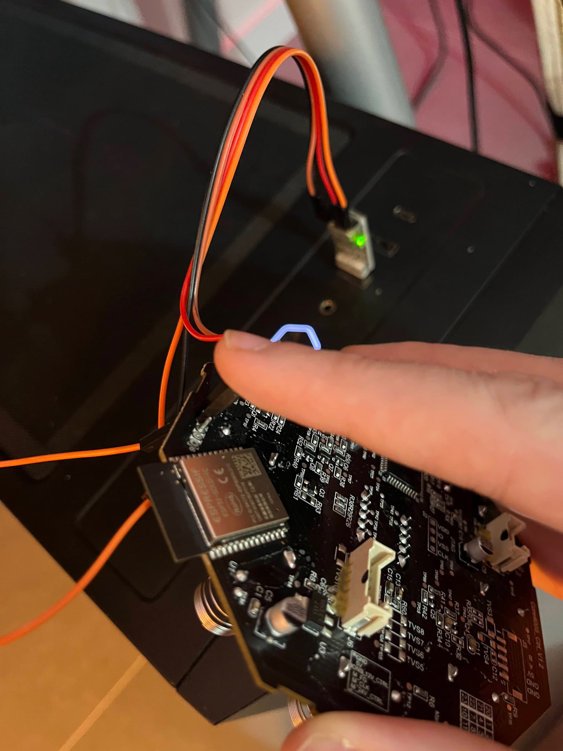

If you double check the blog post, one of the pictures is his amazing soldering work (no judgement, I soldered an esp32 to my desk leg by mistake.):
Now this is where I had some difficulties, because the pin out he used is actually inverted for the 400s. So instead of having TX and RX closest to the esp board, they are actually opposite of that. Once I inverted the pins, and wired IO to GND I was off to the races.

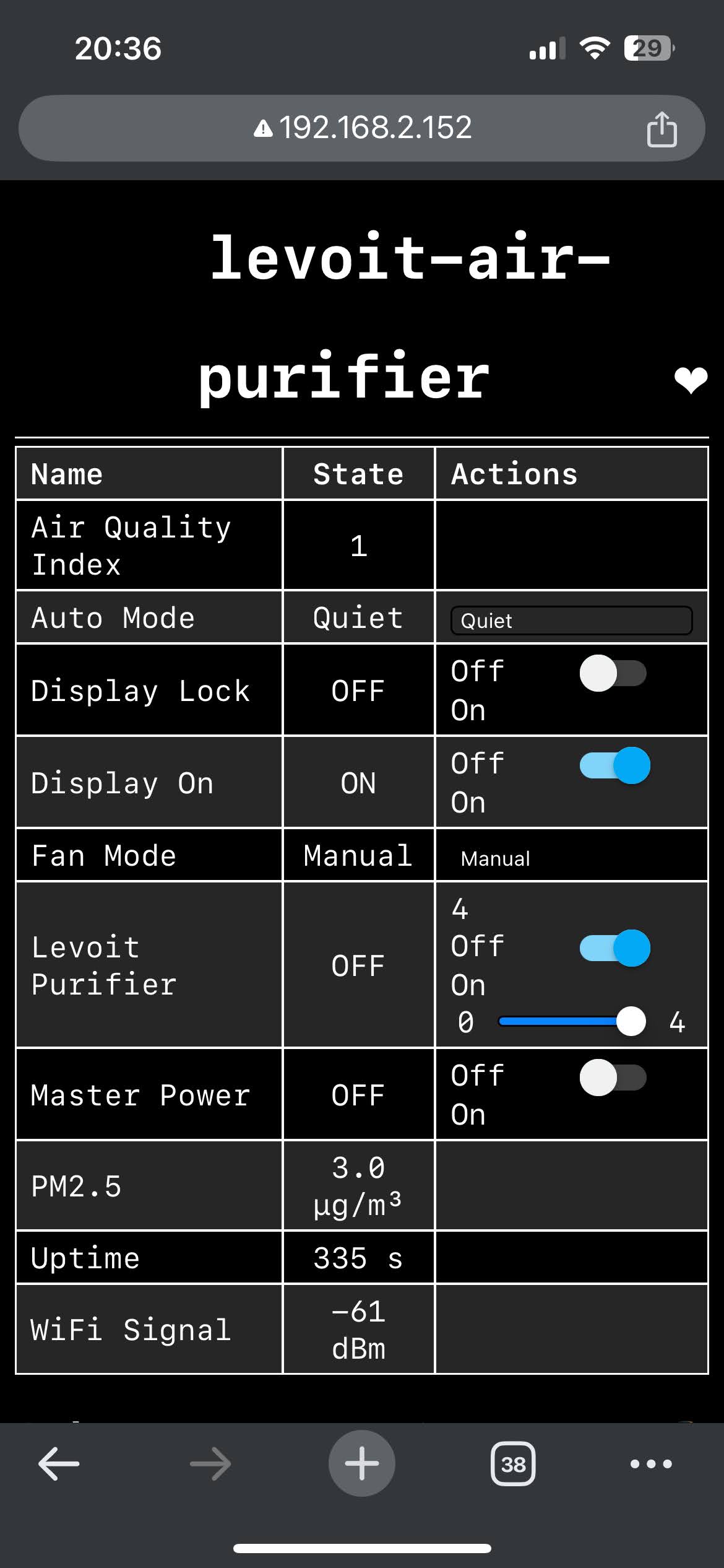

Oh, and because it’s an esp32 I tried my luck and added the web server component. Seems to handle it fine…. Mileage may vary…?

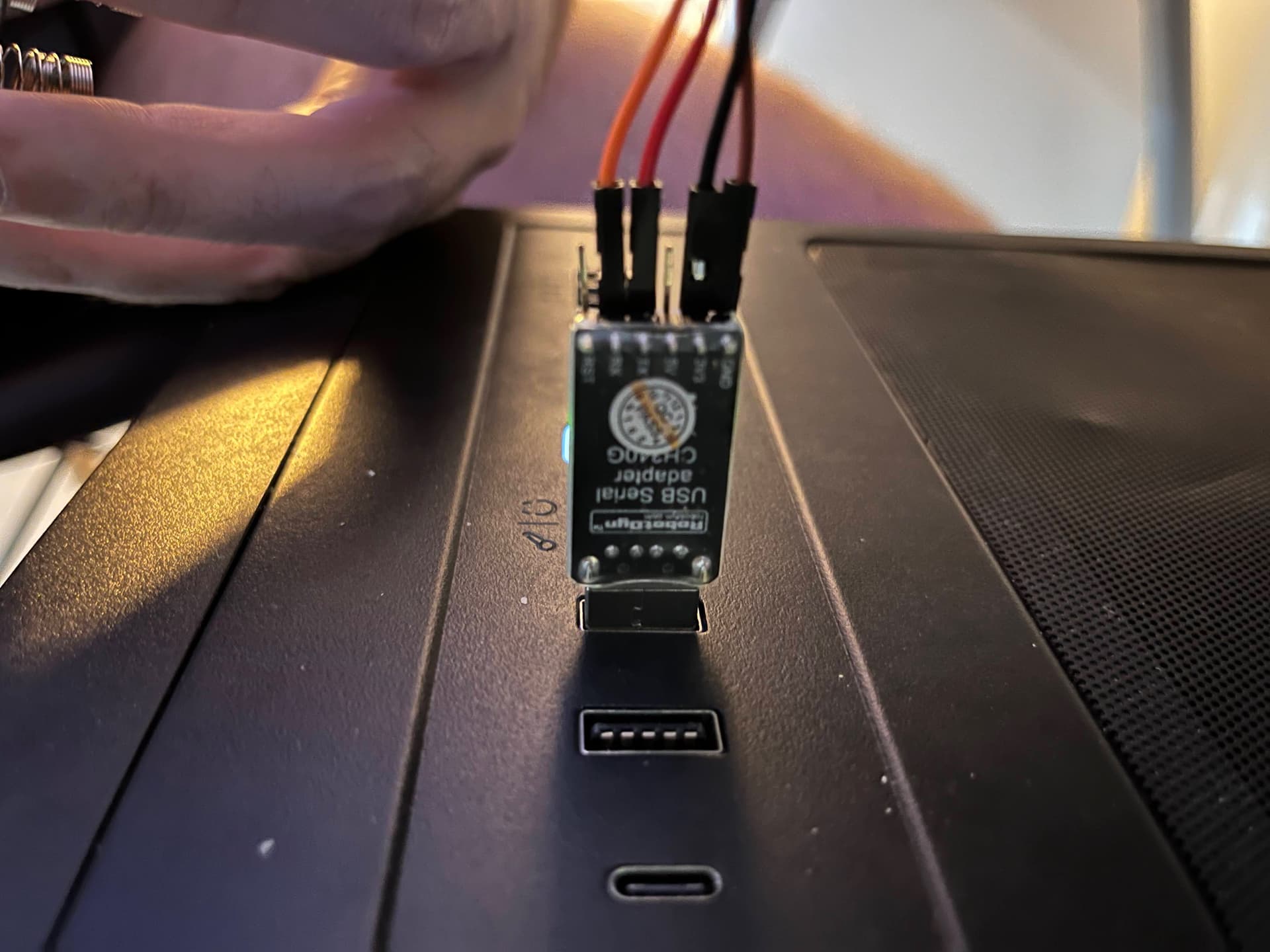

HINT: PLEASE backup your original firmware. I was messing with the pins and when I looked it was already erasing it -.- my bad..

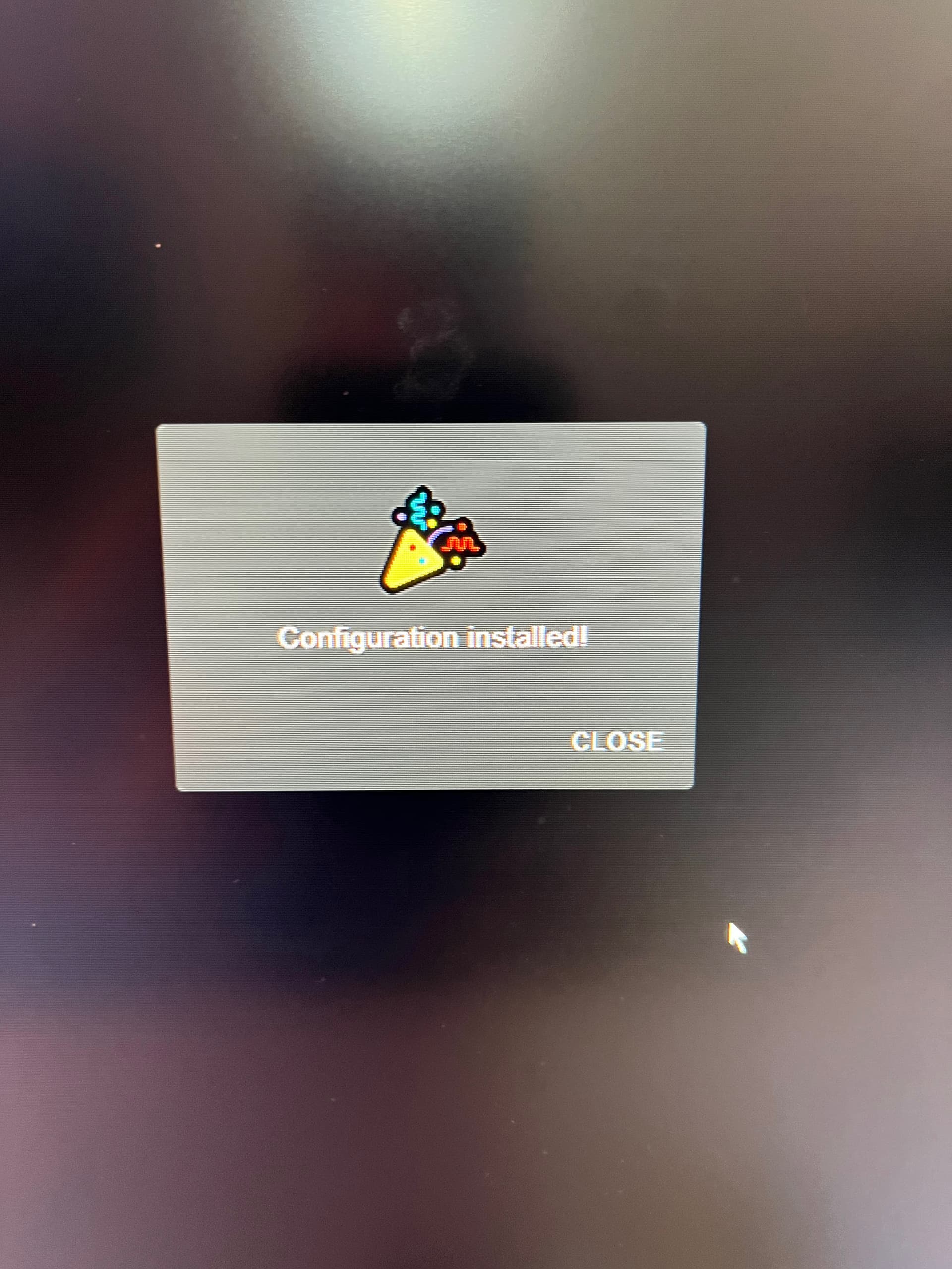

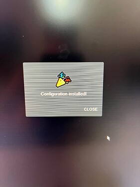

Alright. Time for flashing! FYI I did not solder anything, just used DuPont wires, and lots of cursing.

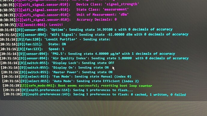

All of the channels are populated and I got data incoming :slight_smile:

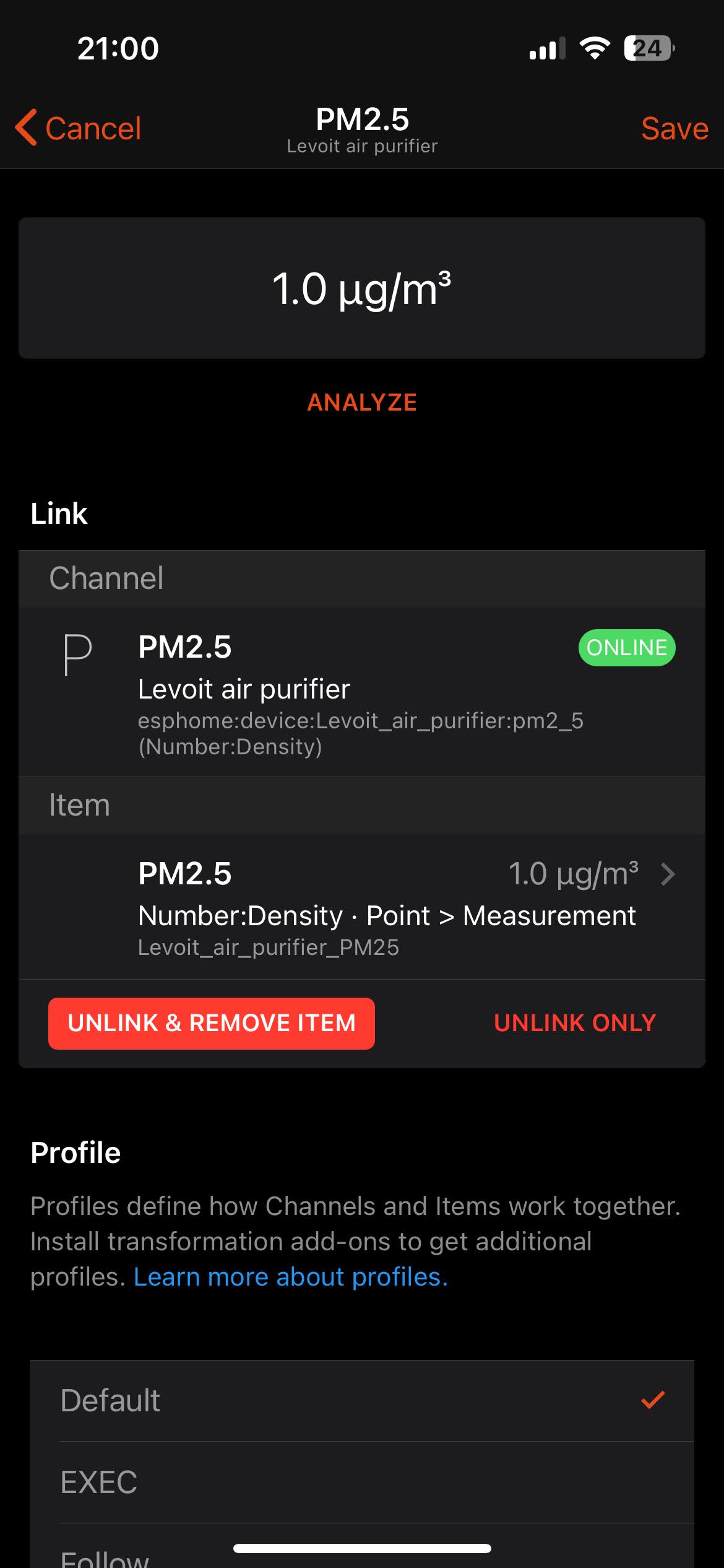

As I’m currently also looking into getting air purifiers, but won’t allow any devices which only work through cloud connections in my openHAB setup, this definitely looks like an alternative, even though opening the device and swapping the ESP32 firmware might not be the most user/warranty friendly solution.

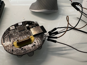

Id you weant to keep original FW/ESP:
https://github.com/tuct/esphome-projects/blob/main/components/levoit/README.md#hardware-setup
=> i fried one of my ESP32 (core300s) and my Vital 100s now has 2 ESP32, only one running, this way, i can always get new FW and switch back to check the protocol if needed
