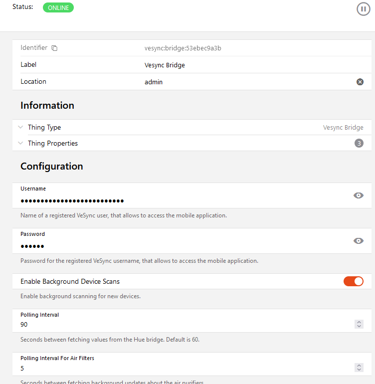

After a Quick Test:
The bridge Item is always Online, even if I try providing it wrong credentials…
