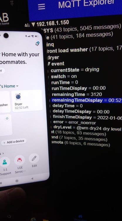

@mgw hi mate ,great job with Thinq ,i have a washer and a dryer.I have a problem with “remainingtime” of the dryer.It shows the minutes right but it cuts the hours.For example if remainingTime is 2 hours and 55 min so 10.500 seconds it shows only 3.300 which is 55 min.See below a screen shot
my washer’s remainingTime is accurate like the LGThinq app.I am from Greece connected at a european server and eng lanquage .Any ideas how to fix that?
There’s an outstanding Pull Request which fixes this.
