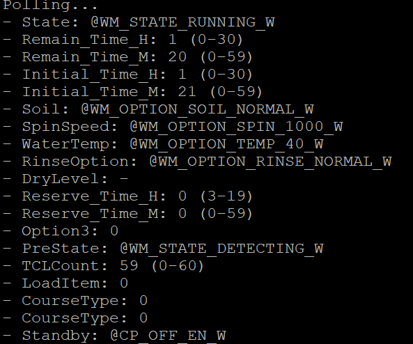

So, i tried it when running, I could get updates on -
  • Time Remaining
  • Previous and Current State eg - Spinning, Running
  • Spin Speed
  • Water Temp
  • Soiling level
  • Rinse Option
What I plan to do is send this across via MQTT to OH and display status there. Not planning to create a binding at the moment

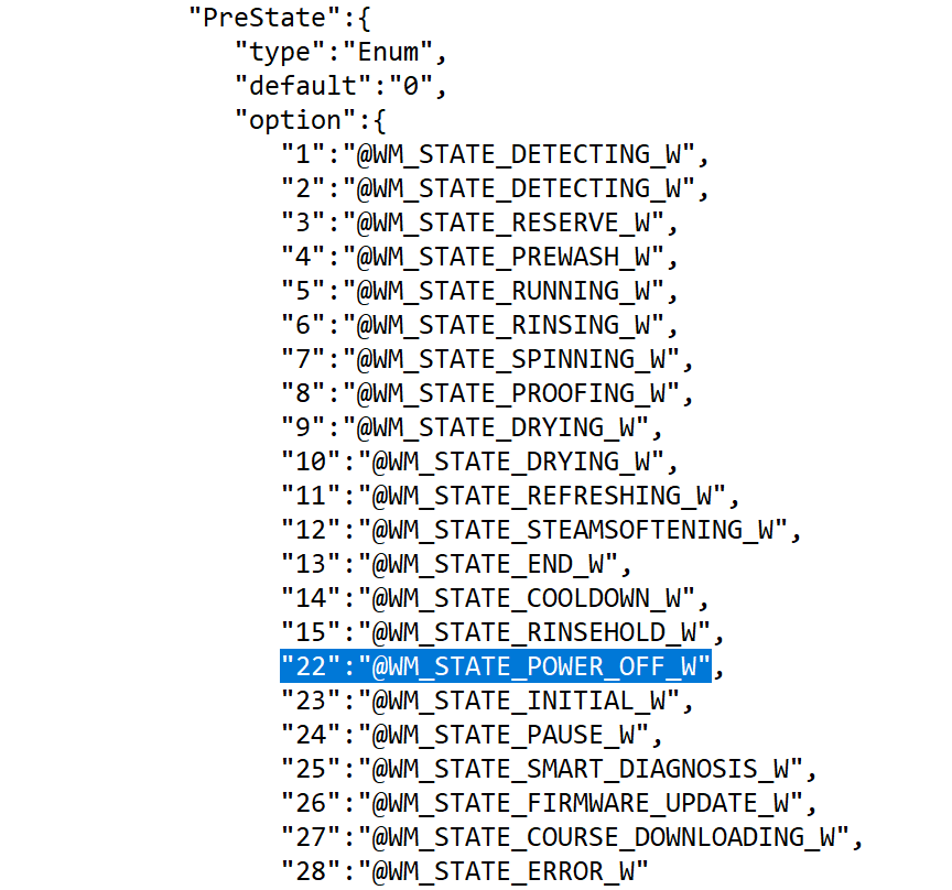

Basically my idea is to dump the complete status from the washer via MQTT to OpenHab and then do the parsing and translation there. So,the MQTT message will be something like
{‘State’: ‘23’, ‘Remain_Time_H’: ‘0’, ‘Remain_Time_M’: ‘0’, ‘Initial_Time_H’: ‘0’, ‘Initial_Time_M’: ‘0’, ‘Course’: ‘0’, ‘Error’: ‘0’, ‘Soil’: ‘0’, ‘SpinSpeed’: ‘0’, ‘WaterTemp’: ‘0’, ‘RinseOption’: ‘0’, ‘DryLevel’: ‘0’, ‘Reserve_Time_H’: ‘0’, ‘Reserve_Time_M’: ‘0’, ‘Option1’: ‘0’, ‘Option2’: ‘132’, ‘Option3’: ‘0’, ‘PreState’: ‘22’, ‘SmartCourse’: ‘0’, ‘TCLCount’: ‘34’, ‘LoadItem’: ‘0’, ‘CourseType’: ‘0’, ‘Standby’: ‘1’}
You can the use your device specific wideq_state.json to determine the values.
Eg PreState 22 is

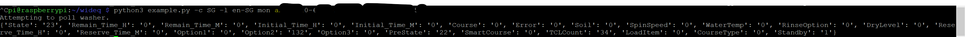

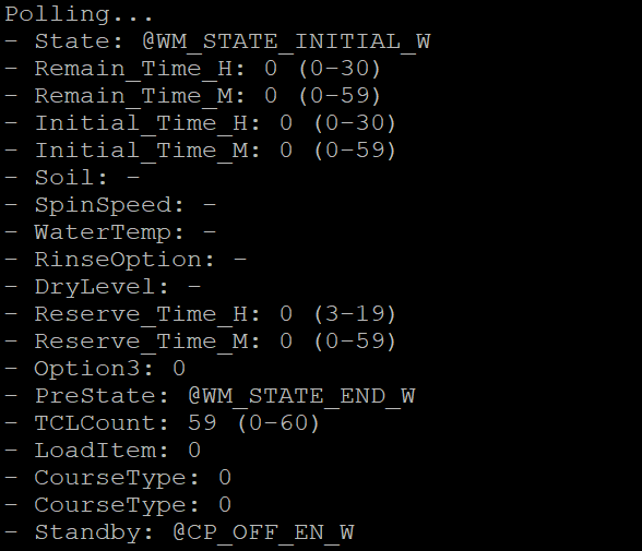

I’vent added the MQTT bits to the code yet. Right now, it will display the response of the device polling like this
