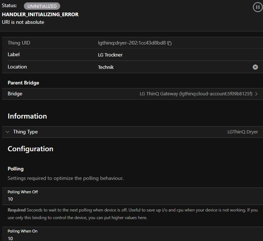

LG ThinQ Binding - does not work as expceted with a LG dryer
I have the LG ThinQ Binding 5.01 installed with OH 5.01 (Windows) which I would like to connect with an LG dryer. The LG Gateway is working and ON
LINE. But after I added the dryer it gives me an error (HANDLER_INITIALIZING_ERROR - URI is not absolute) In detail:

The LG app on the smartphone workes perfectly with the LG dryer. Why there is such errror?
Thanks in advance

This issue is quite characteristic of a corrupted or malformed metadata structure.
Even though the device has a valid identifier, it fails to resolve any of its attributes — including the label, which is a native OpenHab attribute not manipulated by the LG ThinQ binding itself. The Bridge seems to be working correctly, so the problem is likely isolated to the Thing definition or metadata.
To help diagnose the issue, please follow these steps and attach the collected log afterward:
  1. Remove all Things/Devices associated with the LG ThinQ Bridge.
  2. Open the Bridge configuration, disable it and then re-enable it.
  3. Go to the discovery inbox at:
    http://<OPENHAB_HOST:PORT>/settings/things/inbox
  4. Find your dryer (or the affected device) and add it again.
  5. Compress and attach the openhab.log file here.
    (Please don’t paste the content — just attach the file so I can review the complete event history in detail.)
Ok, after removing all Things/Devices associated with the LG ThinQ Bridge - I have only the LG dryer, the LG gateway (online) is seen in the things overview.
Now, when turning on the dryer I can not find any LG dryer in the inbox discovery link, also not the LG gateway.
Is this possible, or do I something wrong?
Did you disable - enable the gateway ? The bridge do the discovery process every hour. To force a discovery process you need to disable/enable the bridge, then when It come back online, it execute the discovery process forced.
I did following steps:
  1. disable LG gateway
  2. turned on dryer
  3. enable LG gateway
  4. waiting 10min while checking the Things-Inbox –> No new dryer or other LG devices were poped up
  5. returned to step1-5 several times - no LG dryer
  6. Added new LG thing → Scan → No LG dryer poped up with auto scan
makes this sense to you? I can see the LG dryer on the smartphone app without problem
Everything suggests that your LG ThinQ Bridge in OpenHab is configured with account information that does not match the account where your devices were originally registered. Please double-check the LG ThinQ mobile app - it is the authoritative source for viewing the devices linked to your account. Confirm the email, region, and language settings used in the app.
After validating this information, delete the existing Bridge from the OpenHab UI and remove all files under <OH_USERDATA>/lgthinq/*. Then restart OpenHab and recreate the LG ThinQ Bridge from scratch, using the exact same account details you confirmed in the app. Once done, check whether the discovery process correctly identifies your devices.
I came here experiencing the same error.
After digging through the logs I found the following:
2025-11-20 17:18:02.912 [WARN ] [ices.LGThinQAbstractApiClientService] - Error calling device list from LG Server API. HTTP Status: 400. The reason is: 0110 - Update Agreement Terms in LG App
2025-11-20 17:18:04.762 [WARN ] [ices.LGThinQAbstractApiClientService] - Error calling device list from LG Server API. HTTP Status: 400. The reason is: 0110 - Update Agreement Terms in LG App
After accepting the terms and disabling and re-enabling the LG bridge, I was able to add my fridge.
That could be the problem. With the smartphone app I registered everything in US although the server with openhab is in CH.
Could this be the issue when the bridge is using the US registration? I did it that way because with CH I had the same issue and read that there are some limitation when using CH in thinQ thing.
The binding does not handle the flow for accepting or updating LG agreements. While this could technically be implemented, it falls outside the scope of the project. I do not see an elegant or intuitive way to incorporate such a process into the OpenHAB UI, especially considering that users must be given the opportunity to review any updated terms before the binding performs acceptance on their behalf. Otherwise, the binding would effectively bypass the user’s review of the terms, which would be incorrect and potentially problematic from a legal standpoint.
Therefore, when this situation occurs, the binding transitions to an OFFLINE state with an informational message indicating that the terms must be updated. Once the user completes this update within the app, the binding will automatically return to ONLINE after some time, or immediately if the bridge is disabled and re-enabled, in cases where the automatic recovery does not happen.
