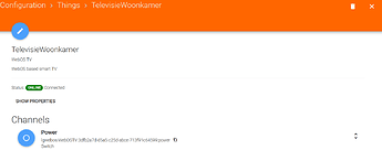

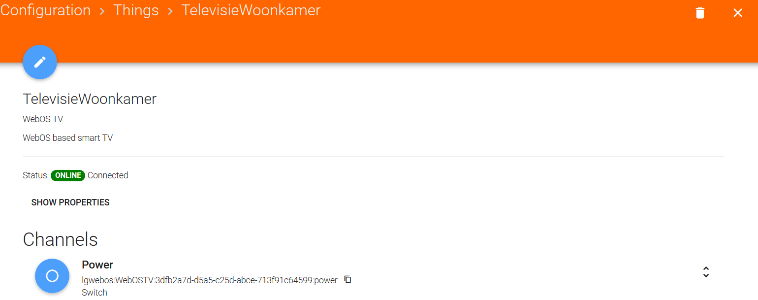

Not sure if this is still your main question but I can confirm that the binding also works using WiFi.
As of today, i switched from ethernet to wifi. Works in both
As I only use Kodi (with CEC) I can turn on the TV. I am not too sure if this binding allows you to power on the TV aswell.
