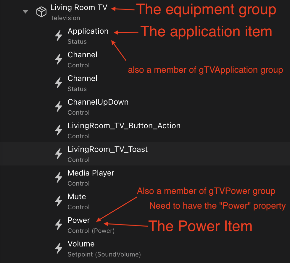

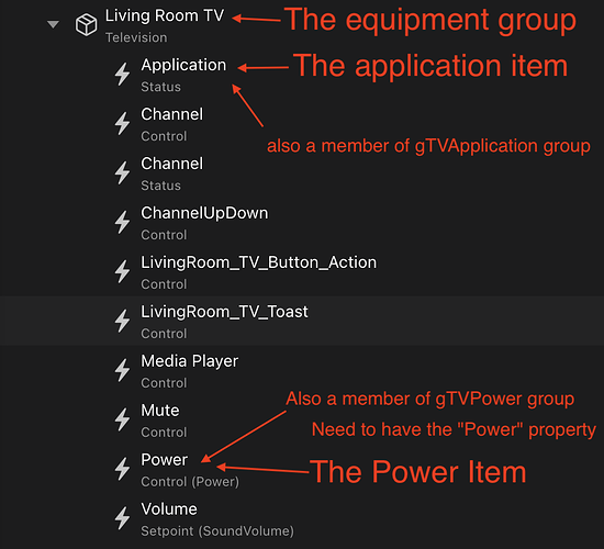

Items setup:
  1. A virtual group gTVPower (not a part of the semantic model)
  2. A virtual group gTVApplication (not a part of the semantic model)
  3. A virtual Group item set as the TV’s “Equipment” Semantic model. For example, it can be called LivingRoom_TV
  4. A TV Power item with Semantic tag Control, Power. It’s a member of the equipment group (3) and the gTVPower group. For example you can call this LivingRoom_TV_Power
  5. A TV Application item with Semantic tag Status. It’s a member of the equipment group (3) and the gTVApplication group. For example you can call this LivingRoom_TV_Application
