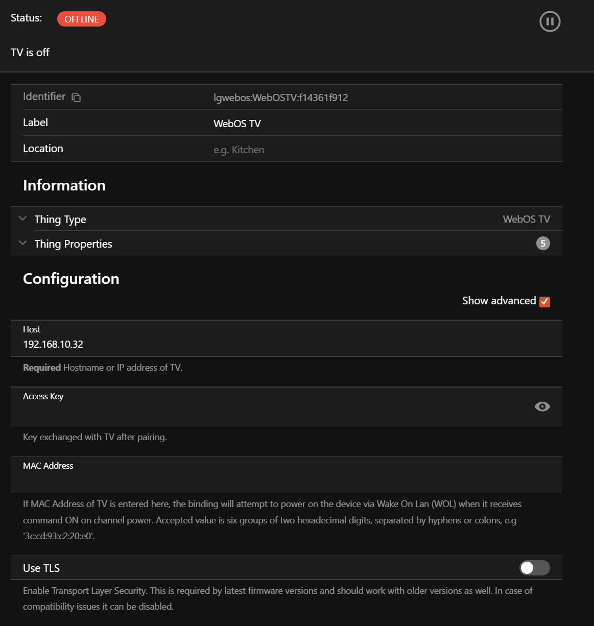

But suddenly the connection stopped working.
I can now only switch on via WOL, but no longer operate anything.
The device always shows the status “TV is off”, so OpenHAB thinks the connection is ok.
Now I don’t know how to pair the TV again.
Even if I enter a random IP address, the device remains in the “TV is off” status and does not notice that there is no longer any connection to the tv.
I’ve also tried deleting and re-creating the device. But even then I can enter any IP address and the status always changes immediately to “TV is off”.

The problem is, that I can’t pair anymore.
I can create a new thing with the ip-adress of the tv, but it never will pairing.
The “access key” field remains empty.
