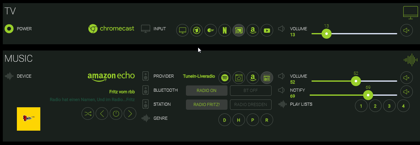

here some more examples of my HABPanel solutions.. This time for the LGWebOS and Amazon Echo Binding…

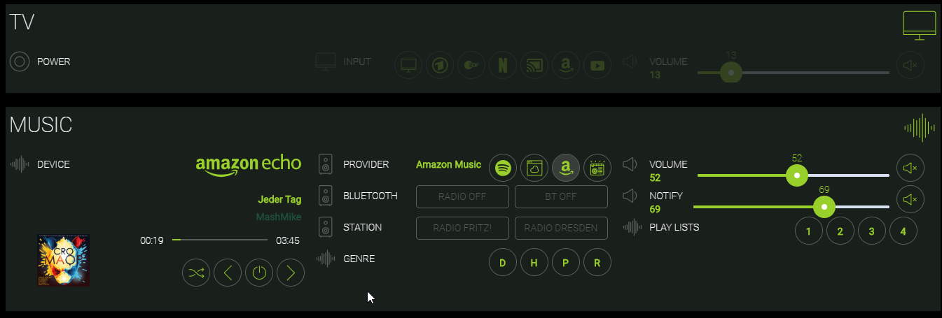

TV OFF & Amazon Music via Echo
TV ON & Radio Station via Echo

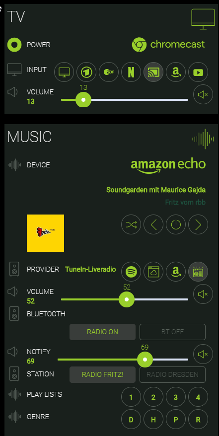

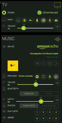

Mobile View
I took the spotify example which comes with the matrix theme, and play a bit to fit my needs.. I also added some svg images to AppIcons.svg and matrixicons.svg. If you sont have the squidink icons bought, you will find a free alternative :slight_smile:
Code is here (click)
