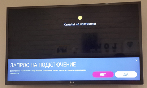

Hi, guys. I spent few minutes today for testing the binding - TV responced immidiately after adding the binding - it asked for allowing / not allowing external connection. Then Openhab welcome message appeared, but I couldn’t control TV from Openhab (tested VolumeControl, PowerControl and ToastControl). Tested on 42LB671V and 32LF653V.
Here are some photos and log errors:
