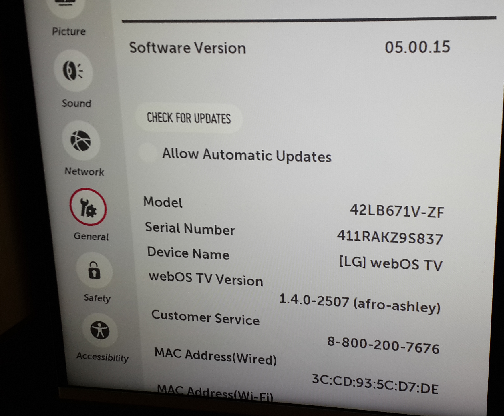

Another observation, according to logs:
My WebOS version is: 4.1.0
@maihacke: yours is 4.0.3

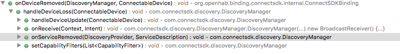

how does the log go on? I walked through the connect sdk code. After receiving the “registered” message it normally should try to store the device in the StoredDevices file or through an exception.
The path looks good.
In DefaultConnectableDeviceStore
`private synchronized void writeStoreToDisk(final JSONObject deviceStore) {
final long lastUpdate = updated;
waitToWrite = true;
    Util.runInBackground(new Runnable() {
        @Override
        public void run() {
            FileWriter out;
            try {
                File output = new File(fileFullPath);
                if (!output.exists())
                    output.getParentFile().mkdirs();
                out = new FileWriter(output);
                out.write(deviceStore.toString());
                out.close();
            } catch (IOException e) {
                e.printStackTrace();
            } finally {
                waitToWrite = false;
            if (lastUpdate < updated)
                writeStoreToDisk(deviceStore);
Hmmm looks good to me. What next? Sadly I could not manage to do remote debugging on my cubie, since rmi is somewhat broken. maybe it is because of the arm platform.

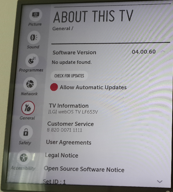

Hi! Finally I’m back.
My story is similar to @Glenn_Bignell’s one.
I’m turning the TV on, starting to click on control buttons from openhab, after 20-25 seconds the binding finds the TV and TV responces - control is available. This miracle lasts for two minutes, then the binding losts the TV. All these manipulations are illustrated in the log below:

Updated the binding - testing scenario and the problem stay the same. New log is uploaded to googledrive
This is so weird. This is somewhere deep down in connect sdk I believe.
The only commonality I see so far, is the older WebOS version. @strelok1986: you also seem to run WebOS 4.0.3. Since you have two TVs, could you maybe upgrade one to 4.1.0 and test if the problems remain?
And do you have the StoredDevices file under openhab/etc/connect_sdk?
Yes, I have [o.o.b.c.internal.ContextImpl ] - Folder path for connect sdk devices: /usr/share/openhab/etc/connect_sdk with StoredDevices:
{“devices”:[{“modelName”:“LG Smart TV”,“lastConnected”:9223372036854775807,“lastKnownIPAddress”:“192.168.0.30”,“modelNumber”:“42LB671V-ZF”,“id”:“3d25509d-e11f-4a33-81ca-6c720e01e6e2”,“services”:{“1eef01bd-461b-8656-0cc3-4c0f1da57322”:{“description”:{“filter”:“urn:lge-com:service:webos-second-screen:1”,“modelName”:“LG Smart TV”,“port”:1444,“ipAddress”:“192.168.0.30”,“modelNumber”:“42LB671V-ZF”,“serviceId”:“webOS TV”,“uuid”:“1eef01bd-461b-8656-0cc3-4c0f1da57322”,“version”:“4.0.3”,“friendlyName”:“[LG] webOS TV”},“class”:“WebOSTVService”,“config”:{“clientKey”:“f35afd81656a170b2adefca958676fe3”,“serverCertificate”:“…”,“class”:“WebOSTVServiceConfig”}}},“lastDetection”:1452974196,“friendlyName”:“[LG] webOS TV”},{“modelName”:“LG Smart TV”,“lastConnected”:9223372036854775807,“lastKnownIPAddress”:“192.168.0.31”,“modelNumber”:“32LF653V-ZC”,“id”:“0250b270-3d3f-4a7d-9efc-e4fcff99ea5e”,“services”:{“5898a6ba-7ee1-80c4-4cbc-68b25015d29d”:{“description”:{“filter”:“urn:lge-com:service:webos-second-screen:1”,“modelName”:“LG Smart TV”,“port”:1458,“ipAddress”:“192.168.0.31”,“modelNumber”:“32LF653V-ZC”,“serviceId”:“webOS TV”,“uuid”:“5898a6ba-7ee1-80c4-4cbc-68b25015d29d”,“version”:“4.1.0”,“friendlyName”:“[LG] webOS TV LF653V”},“class”:“WebOSTVService”,“config”:{“clientKey”:“6586493eea26f60ecebfd6b2be0efc9f”,“serverCertificate”:“…”,“lastDetection”:9223372036854775807,“UUID”:“5898a6ba-7ee1-80c4-4cbc-68b25015d29d”,“class”:“WebOSTVServiceConfig”}}},“lastDetection”:1453017302,“friendlyName”:“[LG] webOS TV LF653V”}],“created”:1452017882,“version”:0,“updated”:1453017302}
And I checked firmware version - it’s the freshest on both TVs, no updates are available.
I wonder what could trigger the device to be removed. According to your reports is seems to be some sort of timeout. Maybe something buggy in the websocket communication: bug in java-websocket lib, energy saving setting on TV?, something todo with the underlying OS …
I checked where onDeviceRemoved, which produces the log statement “Device removed:”, gets called…
handleDeviceUpdate and setCapabilityFilters:
I never set the capabilityFilters. so this should actually never call handleDeviceLoss
onReceive
This should at least produce a log entry: “Network connection is disconnected”
onServiceRemoved
This should produce a log entry: “onServiceRemoved: friendlyName: …”
I don’t see those in the logs. Can you check please?
Do you have the ability to remote debug? Set a breakpoint in ConnectSDKBinding.onDeviceRemoved and check out the stack, who is calling this…
