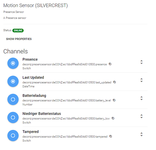

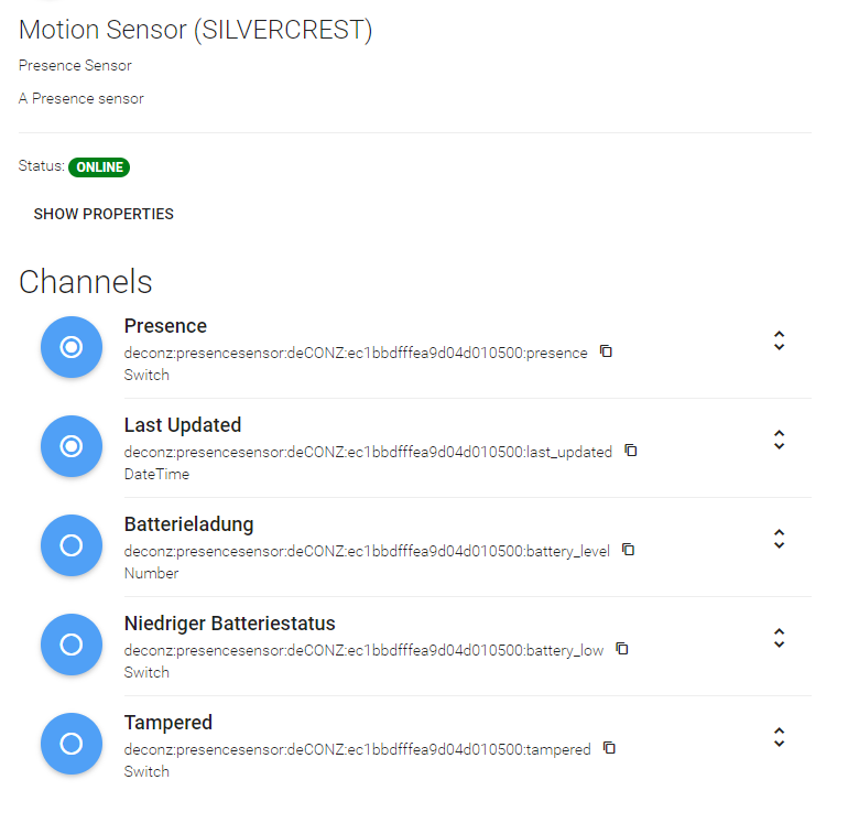

Hallo
Ich nutze Silvercrest Motion Sensor auf Raspberry / Openhab 2.5.1 / deCONZ / ConBee II
Ich habe sowohl die Version 2.07.02 als auch 2.09.01 installiert. Das Verhalten ist gleich.
Der Sensor wird erkannt und läuft auf/in Openhab gut (die Einbindung ist recht wackelig aber es geht)
Ein offener Punkt ist die Dauer der Detektion Anzeige. Der Sensor zeig 65 Sekunden „detected“ an.
Ich schalte über den Sensor eine Steckdose.
Womit ich nicht zufrieden bin ist die Reichweite ist mit10 m angegeben. DAS stimmt bei meinem Sensor nicht einmal annähernd!

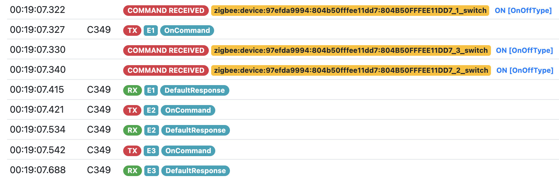

I can confirm, that the Lidl Powerstrip indeed does work using zigbee2mqtt and a CC2531 Zigbee Dongle using firmware CC2531_DEFAULT_20190608.
The same goes for the Lidl switched socket.
I can switch each plug individually and they also report their state, when switched by other means, like the on/off button the powerstrip or switched socket. It did take a bit of fiddling, but well happy with that.
Oh, and that’s the UK/Ireland version of both in my case, but that shouldn’t really make a difference.

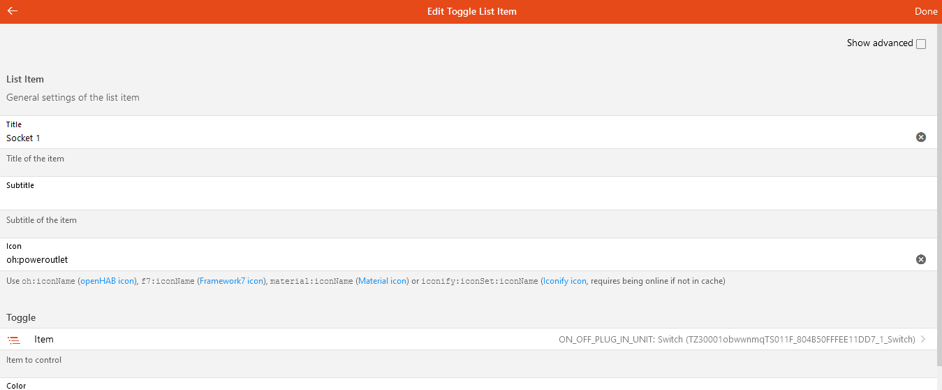

I can also confirm, that the Lidl Powerstrip does work using the Zigbee Binding on OpenHAB 2.5.12 with a Bitron Zigbee USB dongle.
The names for the items have to be changed during creation, as the default names result in unwanted behaviour, but once that’s taken care of, all 3 sockets can be switched individually.

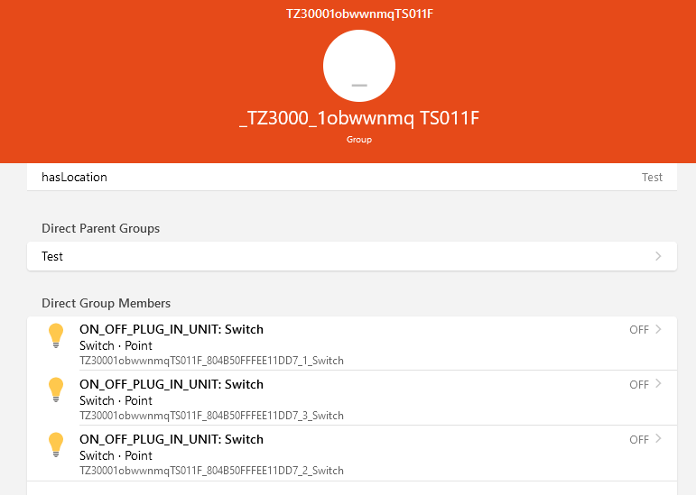

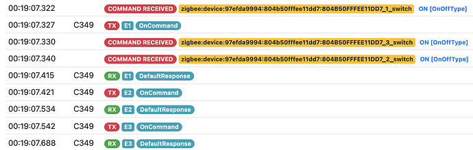

@chris

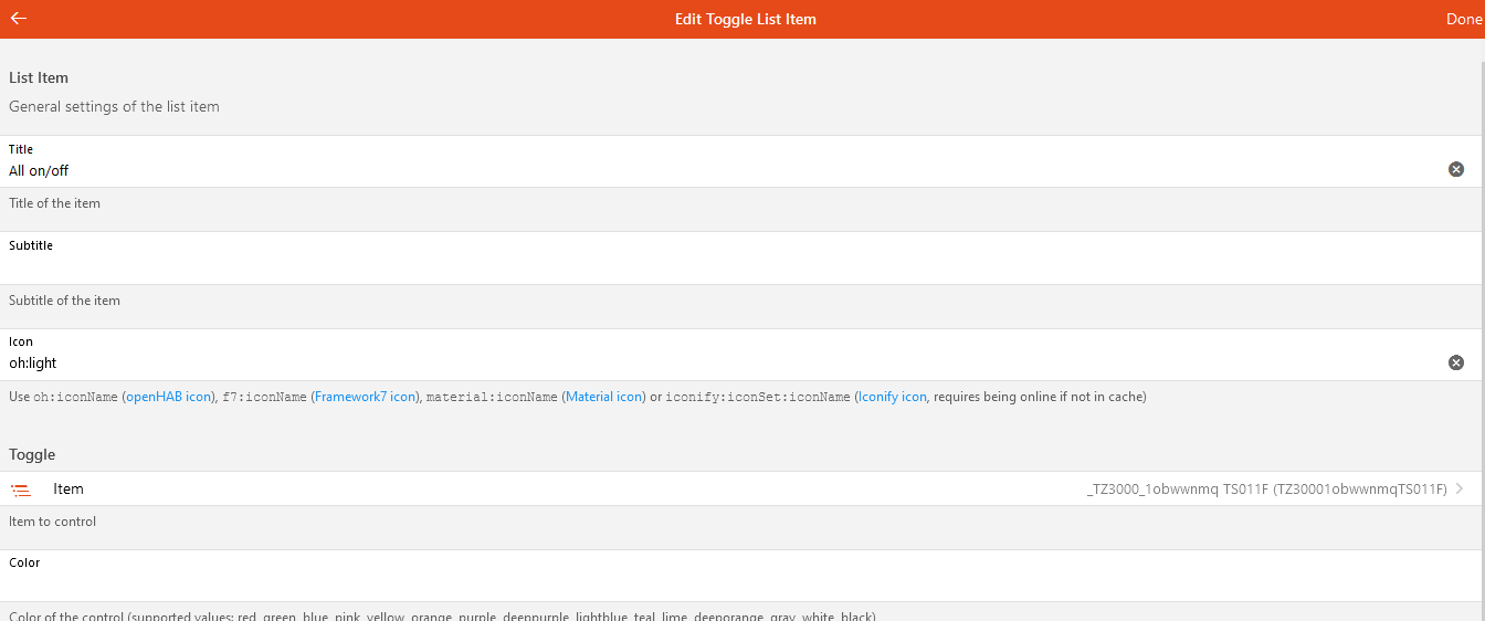

HW: Silvercrest power strip, 3 sockets, IEEE address 804B50FFFEE11DD7
SW: openhabian 3.2.0-SNAPSHOT - Build #2583, OH Zigbee binding, Ember Coordinator @ 6.7.8.0
Problem:
All three sockets can be individually switched on and off, ‘All sockets on’ works, but ‘All sockets off’ doesn’t work (no reaction).

Configuration of ‘All on/off’ item:
And for socket 1:
Log file for “All sockets off → Click ‘All on/off’ (result: all sockets on) → Click ‘All on/off’ (no reaction)”:
powerstrip_all_on_off.txt (80.6 KB)
AFAICT from the log, the first click on the toggle switch works as one would expect:
00:19:07.307 [INFO ] [openhab.event.ItemCommandEvent       ] - Item 'TZ30001obwwnmqTS011F' received command ON
00:19:07.311 [INFO ] [openhab.event.ItemCommandEvent       ] - Item 'TZ30001obwwnmqTS011F_804B50FFFEE11DD7_1_Switch' received command ON
00:19:07.314 [INFO ] [openhab.event.ItemCommandEvent       ] - Item 'TZ30001obwwnmqTS011F_804B50FFFEE11DD7_3_Switch' received command ON
00:19:07.317 [INFO ] [openhab.event.ItemCommandEvent       ] - Item 'TZ30001obwwnmqTS011F_804B50FFFEE11DD7_2_Switch' received command ON
but there are no lines corresponding to the second click on the toggle switch.
As seen from the UI:
All off.
Click on ‘All on/off’:
All on. OK.
No reaction: all three socket are on (UI and real life).
Am I correct in assuming that the “all” item is a group that just groups up the individual sockets? If so, I’m not sure why it wouldn’t work from a binding perspective if the individual commands work. An OH group command is expanded to individual commands before it gets to the binding, so it will be exactly the same as sending the 3 individual OFF commands.
I think this must be an issue with the core/ui. I’m going to guess that it’s an autoupdate issue - the device doesn’t send a state update, and the binding doesn’t update the state after sending the command, so the state of the item is still OFF, and therefore the core doesn’t propagate your second toggle to switch it OFF as it already thinks it is OFF.
I’ve just been looking at the way the binding handles this. Normally the binding expects the device to send a report to update the state, but in this case it’s not received so presumably this device doesn’t send it for some reason.
I think I will change the way this works slightly to also update the state if the binding receives the successful response to the command.
FTR -:
To be precise: the ‘All on/off’ UI element is a Toggle List Item within a List Card (type: Media) that references the Power Strip:
That’s all - no ‘grouping’ etc. from my side.
O, but what channel are you linking to? If I look at the log, the binding is receiving individual commands so as far as I can see, this is in some way a group that sends individual commands to the individual channels.
OK, the group was created by adding the Thing to my Model while selecting all three channels/sockets. So yes, something sends an ON command per socket (in quite a strange order: 1, 3, 2), but it doesn’t send OFF commands.
As I said earlier, this is almost certainly because the core thinks the state is still ON, so it doesn’t send another OFF.

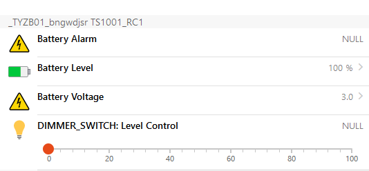

Channels:
UI:
ZigBee debug logs (button 1, 2, 3, 4 (from top → bottom) pressed):
Problem:
No corresponding events in event.log.
