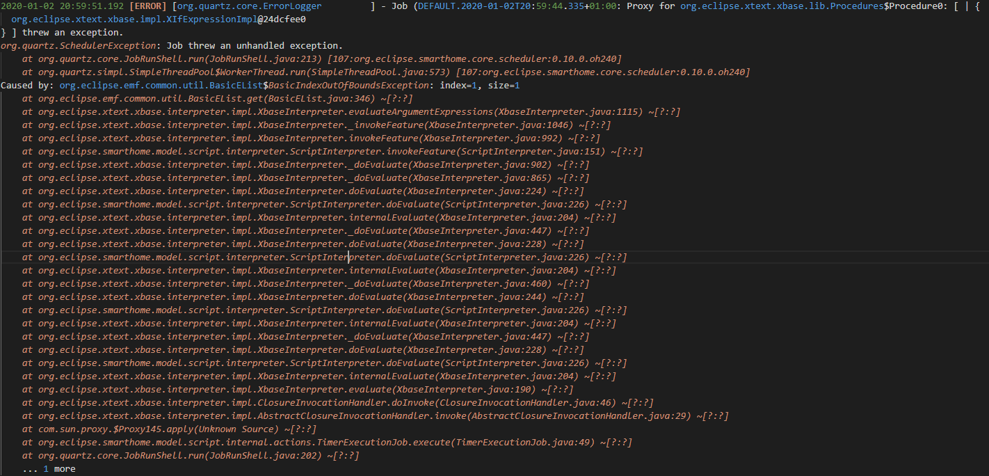

Unfortunately, this works very unreliably. I get tons of BasicIndexOutOfBoundsExceptions raised in XbaseInterpreter.evaluateArgumentExpressions and only few color zones are dimmed completely:
Any ideas what could I could have done wrong? What does this error mean? Anyway, I wonder whether the strip indeed does not provide a more specific interface …
