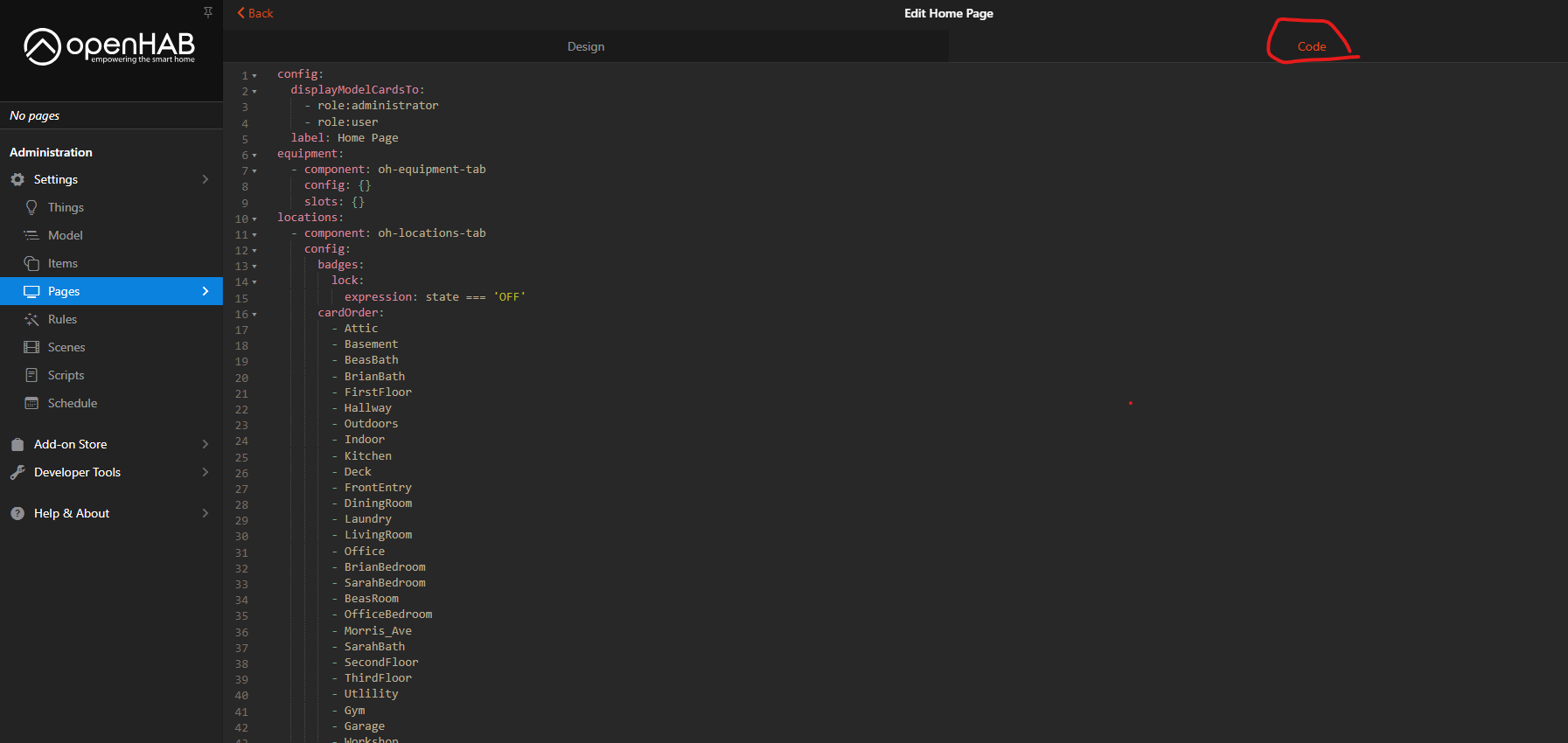

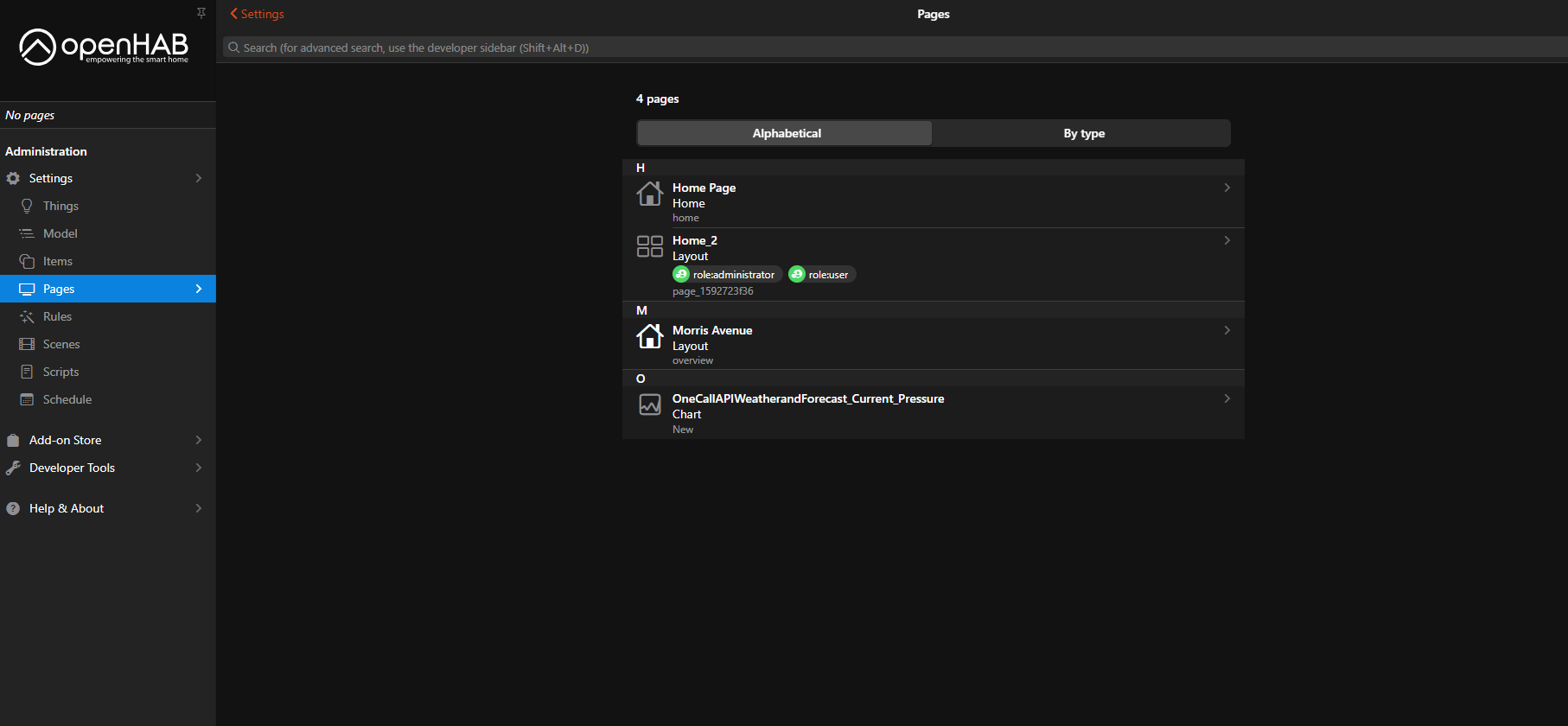

In Settings, Pages, select your Home page
Then switch to the Code tab at the top
Copy that and post here using code fences
