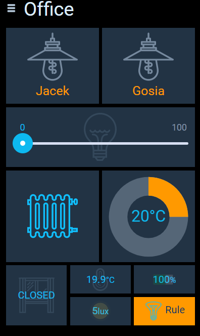

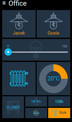

I have change the code according to your proposal. It seems to work but I have one more challenge.
When the conditions are met and timer starts if someone in this state switches the rule button off (deactivates the rule) and leaves the room, lights will turn OFF when timer elapses.
My intention is to not react at all if the rule button will be deactivated and leave the light status as it is. Just stop the rule completely. Activate it again from the beginning when the rule button is activated again

Yes. After the rule creates the Timer, it has an independent existence. You could delete the rule, it wouldn’t affect the scheduled timer.
Then don’t use the “rule button” as a user control.
Create a dummy Item that you can control from the regulare UI. call it “Enble Light Auto” or something.
Modify the rule and timer code to check the state of that Item before taking actions.
