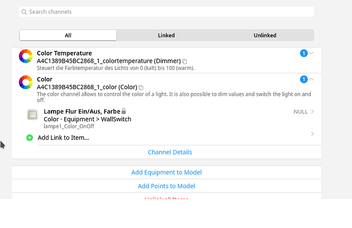

the device has only two channels:
  1. Color Temperature- it controls the spectrum of the light as expected and
  2. Color: the manufacturer wrote in the description of the channel in OpenHab:
    “The color channel allows to control the color of the light. It is also possible to dim values and switch the light on and off”
    The channel is default == null.
    I can switch the lamp on/off with my wall switch, but with what kind of values of the channel I can switch on/off, dimm or set set colors of the bulb?
    Has anybody an idea?
The screenshot of the channels:
Screenshot1
Sincerely :slight_smile:
Jens
You can send ON-OFF and Dimming commands to the Color channel.
EDIT: so connect a Switch or Dimmer item to that Channel.

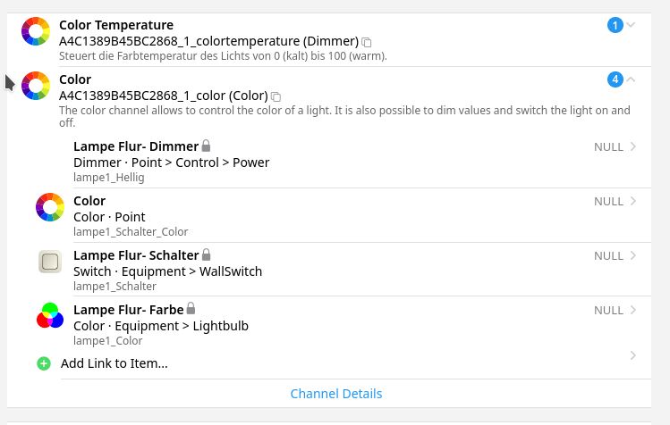

it doesn’t work. All 4 channels are online, but the values of the 3 Channels from the channel Color are null. I can set commands with the karaf-console, but nothing is going on, the values are still null.
I can set Channel Color Temperature, the values are saved, but the bulb will doesn’t respond.
The screenshot:
grafik
The Item “Color” (lampe1_Schalter_Color) from the channel “Color” is building by OpenHab, the other 3 Items (lampe1_helligkeit, lampe1_Schalter,…) are defined in a item-File- you can see it on the attached file:
lampeZigbee.items.txt (830 Bytes)
Has you an idea, how to fix it?
And how I can switch the logging of ZigBee from Info to Debug in Karaf?
:slight_smile: Jens
now it is working.
It seems, it was a problem with the routing of the zigbee signals.
Now I can use all ZigBee-Properties without problems.
Thanks for the help :slight_smile:
