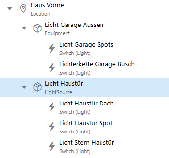

I want the “Lights” badge to appear in the location card of a room when I turn on lights in that room. (Ideally, it would also show the number of lights turned on.)
I’ve sorted the lights into two subgroups. It works for some lights, but not for others.

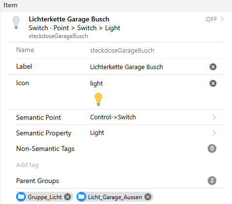

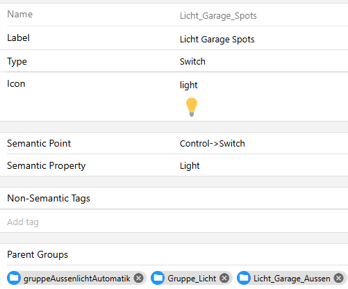

here it’s working:
here not:
What could be the problem, and what do I need to check?

For the lights to appear as badge on the location tab, they need to be member of that semantic location. But they cannot be member of two semantic groups!
