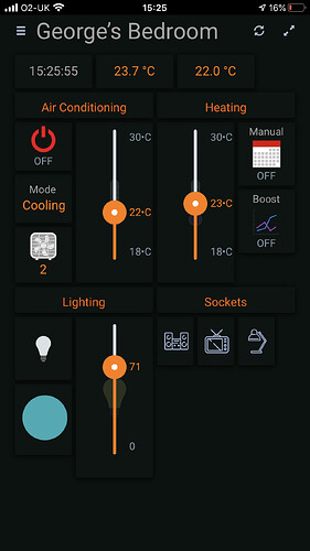

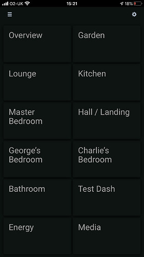

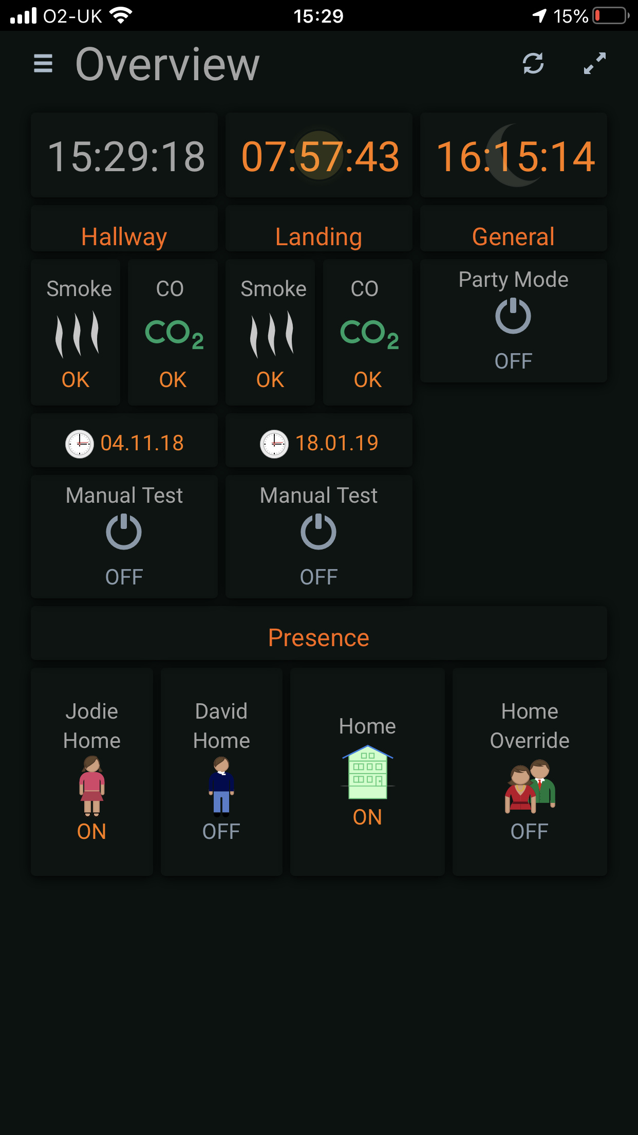

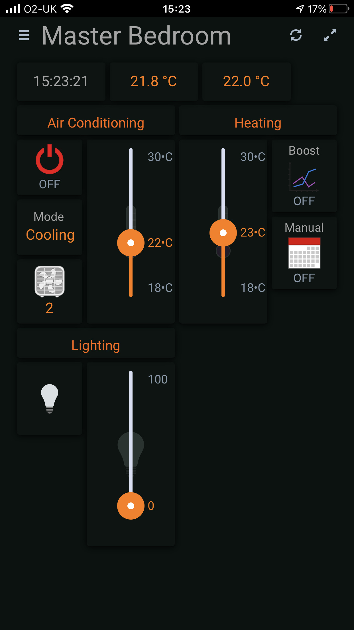

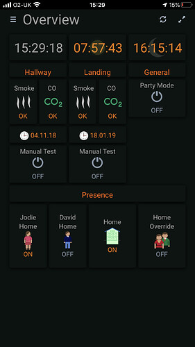

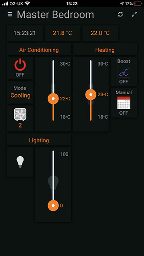

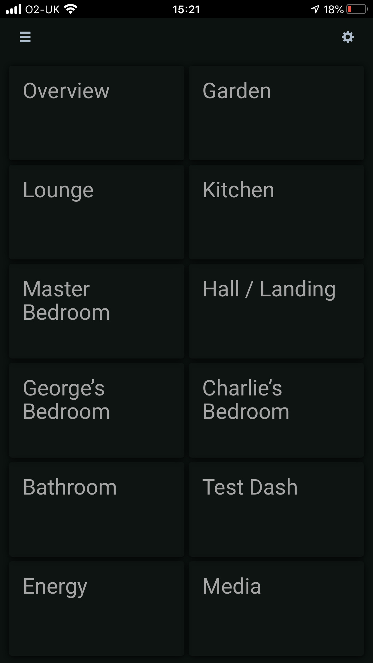

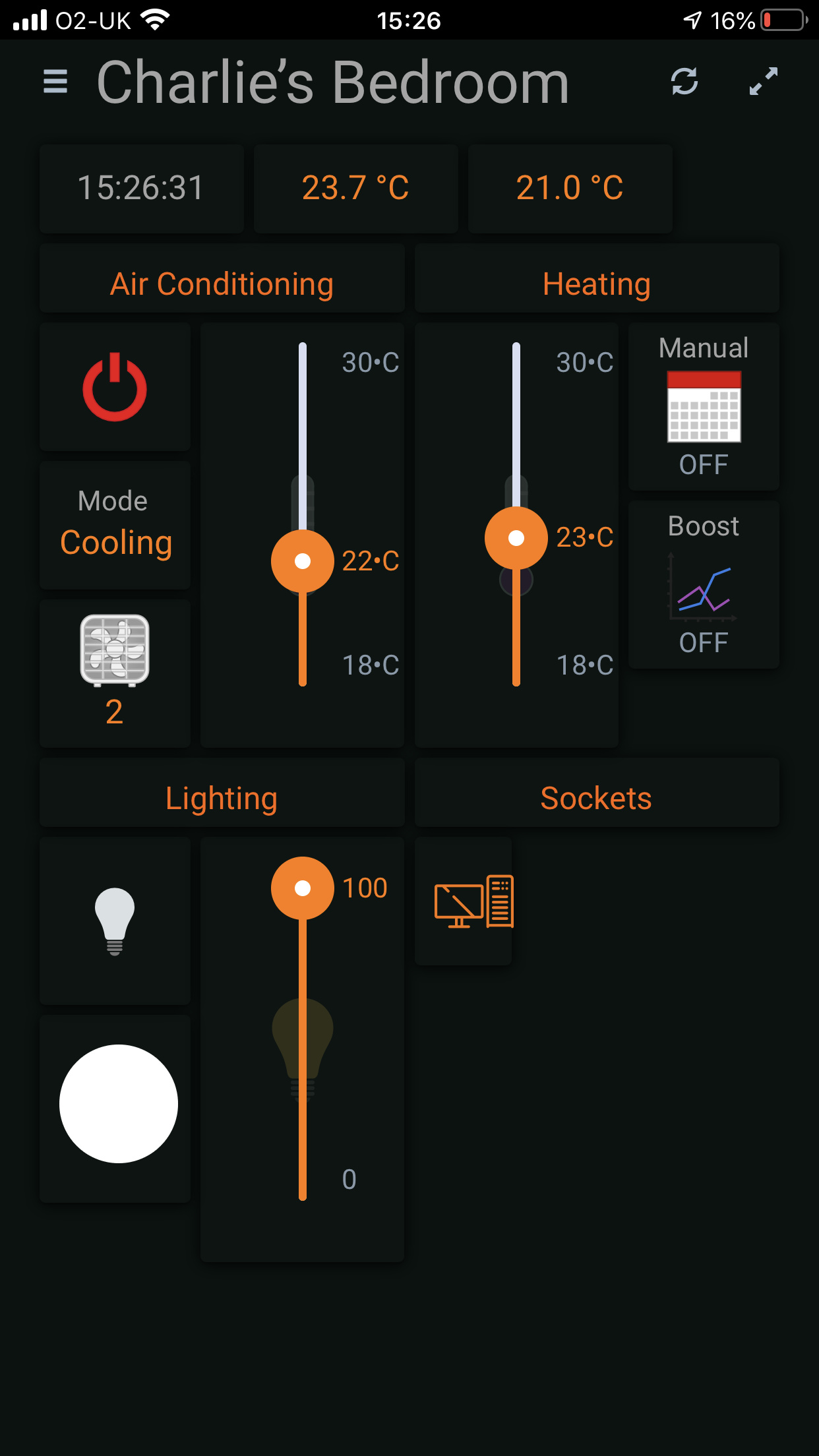

@Greigc my habpanel at present (scales to tablet) but far from finished (only used when out of house remotely, haven’t got round to wall mounts yet)
