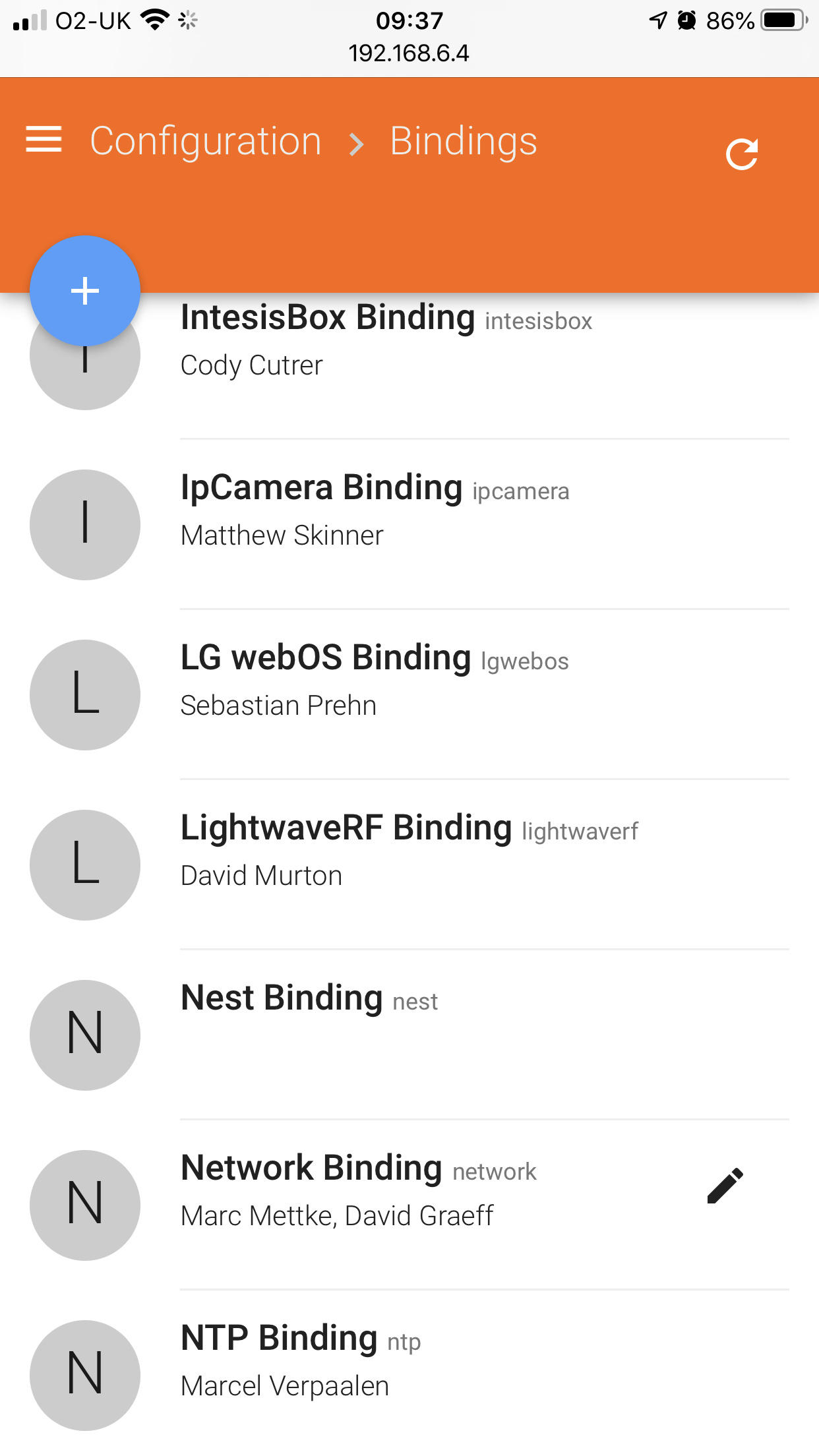

@Greigc When you say under bindings you mean here:
And you got the latest version from git or couple of posts above? And if above you removed .txt extension yes..
@Greigc turn on debug logging, remove and re-add and check the logs. Should show up.
And your putting here:
usr/share/openhab2/addons

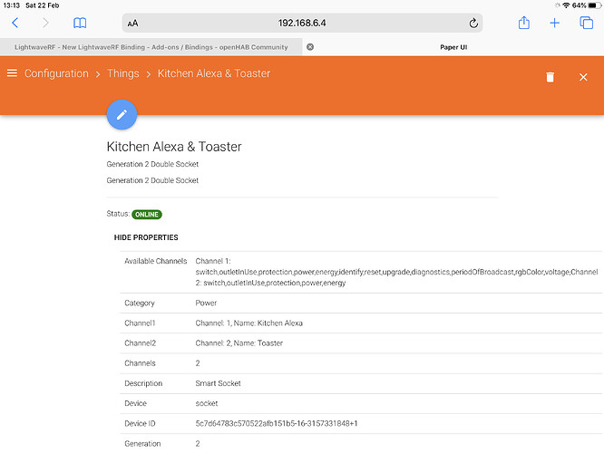

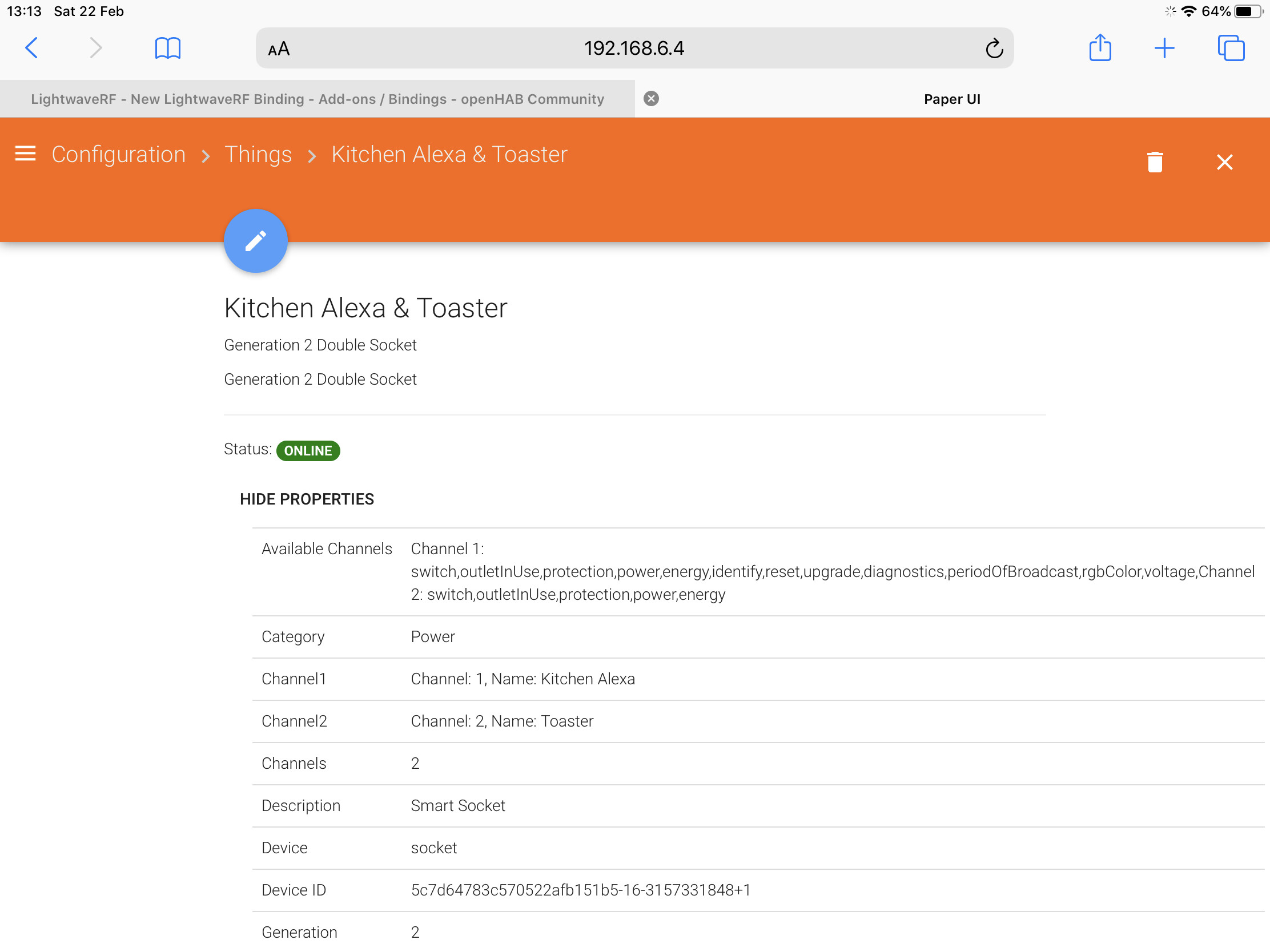

If you have added your account thing, you should now be able to got to inbox.
Then search for devices.
When it finds your gen one hub add it (unknown device)
Then go to the thing it creates (configuration / things)
Find the added thing and click on it.
Then click the show properties button and it should list the channels as per my screenshot. Send me this and I will integrate it

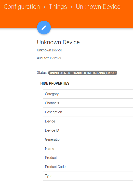

Using 1.1.5 I could add an unknown device, and the logs show that all is not quite well yet. The properties of the new Thing don’t have any details, but at least they are showing the headings.
2020-02-23 12:00:23.940 [DEBUG] [averf.internal.handler.DeviceHandler] - Initializing lightwaverf:device handler.
2020-02-23 12:00:23.943 [DEBUG] [averf.internal.handler.DeviceHandler] - initializeBridge ONLINE for thing lightwaverf:device:94fe32ff
2020-02-23 12:00:23.986 [ERROR] [nal.common.AbstractInvocationHandler] - An error occurred while calling method 'ThingHandler.initialize()' on 'org.openhab.binding.lightwaverf.internal.handler.DeviceHandler@e14d6': null
	at org.openhab.binding.lightwaverf.internal.handler.DeviceHandler.properties(DeviceHandler.java:131) ~[?:?]
	at org.openhab.binding.lightwaverf.internal.handler.DeviceHandler.initialize(DeviceHandler.java:80) ~[?:?]
	at sun.reflect.GeneratedMethodAccessor53.invoke(Unknown Source) ~[?:?]
	at sun.reflect.DelegatingMethodAccessorImpl.invoke(DelegatingMethodAccessorImpl.java:43) ~[?:1.8.0_222]
	at java.lang.reflect.Method.invoke(Method.java:498) ~[?:1.8.0_222]
	at org.eclipse.smarthome.core.internal.common.AbstractInvocationHandler.invokeDirect(AbstractInvocationHandler.java:152) [bundleFile:?]
	at org.eclipse.smarthome.core.internal.common.Invocation.call(Invocation.java:52) [bundleFile:?]
	at java.util.concurrent.FutureTask.run(FutureTask.java:266) [?:1.8.0_222]
	at java.util.concurrent.ThreadPoolExecutor.runWorker(ThreadPoolExecutor.java:1149) [?:1.8.0_222]
	at java.util.concurrent.ThreadPoolExecutor$Worker.run(ThreadPoolExecutor.java:624) [?:1.8.0_222]
	at java.lang.Thread.run(Thread.java:748) [?:1.8.0_222]
2020-02-23 12:00:23.996 [ERROR] [core.thing.internal.ThingManagerImpl] - Exception occurred while initializing handler of thing 'lightwaverf:device:94fe32ff': null
2020-02-23 12:00:23.909 [hingStatusInfoChangedEvent] - 'lightwaverf:device:94fe32ff' changed from UNINITIALIZED to INITIALIZING
2020-02-23 12:00:23.997 [hingStatusInfoChangedEvent] - 'lightwaverf:device:94fe32ff' changed from INITIALIZING to UNINITIALIZED (HANDLER_INITIALIZING_ERROR)
2020-02-23 12:00:32.686 [DEBUG] [rf.internal.handler.LWAccountHandler] - Initiate Polling
2020-02-23 12:00:32.688 [WARN ] [rf.internal.handler.LWAccountHandler] - Channel List For Updating Is Empty, rescheduling
2020-02-23 12:00:42.689 [DEBUG] [rf.internal.handler.LWAccountHandler] - Initiate Polling
2020-02-23 12:00:42.691 [WARN ] [rf.internal.handler.LWAccountHandler] - Channel List For Updating Is Empty, rescheduling
