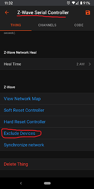

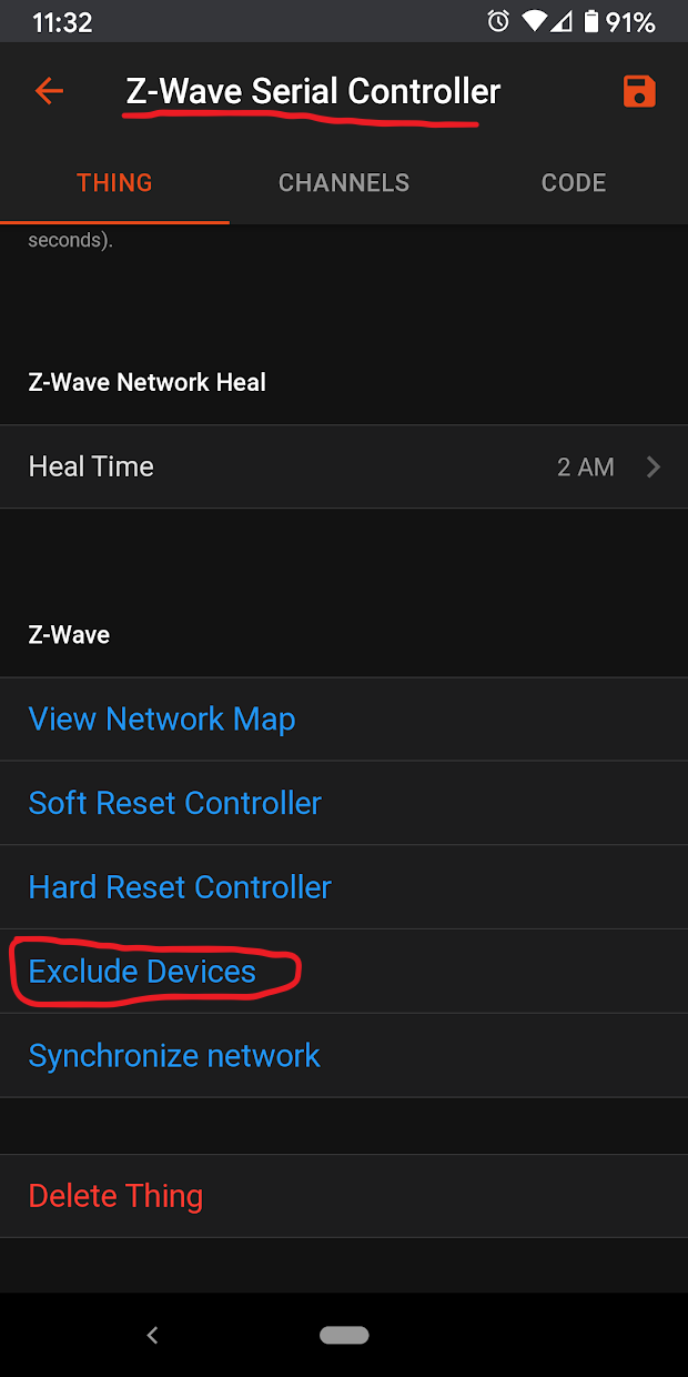

EXCLUDE first. Settings > Things > zwave serial device > exclude devices button. Then press the button on top of the NGD00Z. You will hear a long beep indicating it has been excluded.
Back out to the thing list. Wait for the z-wave devices to come back online in a few seconds.

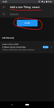

Press the blue (+) button to add a new thing.
Select Z-Wave Binding, then press the blue Scan button.
Within 15 seconds (don’t delay), press the button on top of the NGD00Z. You will hear a beep when you press the button, followed by three beeps indicating it has been included successfully.
