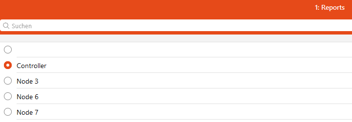

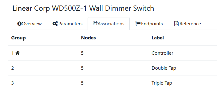

Add the devices to be switched to Association Group 2 or 3.
Z-Wave database:
OH 3.1 Settings → Things
Click on ‘Save (Ctrl-S)’:
Thanks for the reply! I figured that’s how it worked. I tried saving a node id under the double tap.. hit save it shows up but when I refresh it disappears. Seems like its not sticking. Ill have to play around and report back.
