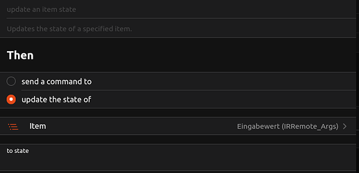

  1. In OH3 with rules, buttons or widgets I can only send commands. I cant update/change states as parameter → I want “to state” as something link “IRRemote_Args.Command”

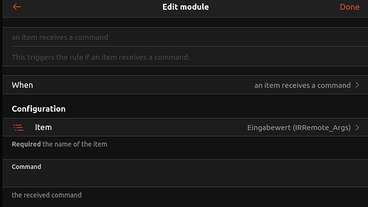

  1. I am not able to set up a rule like: when item receive any command than change item.state to command (“Command” is required and i dont want to set a specific command - I want to set “Command” to “Any”)

UI buttons and widgets always send commands, and only commands.
Do either from any rule. Your screenshot shows a state update action.
But the GUI point and click action is limited to pre-configured constants.
Use a script rule action for more complex evaluations.
If you use a scripted action, then you might as well use executeCommandLine() (or equivalent) to run that directly, and not bother with exec binding.
openHAB has a feature called ‘autoupdate’ that automatically does that for each Item by default. If that’s not working for you, you might want to investigate why.
autoupdate can be disabled for individual Items, or it may be suppressed if the Item is linked to some bindings (or a broken channel).
The command does need to ‘fit’ the Item type, i.e. commanding “banana” to a Switch won’t work.
