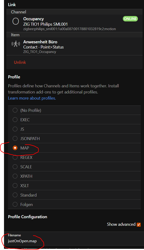

To filter out the unwanted “OFF” command, I’ve created a “justOnOpen.map” transformation file:
ON=OPEN
OPEN=OPEN
OFF=EXPIRE
CLOSED=EXPIRE
which sets the unwanted ‘OFF’ or ‘CLOSED’ to something which does not update the status of my contact item for the presence. This prevents ‘OFF’ and/or ‘CLOSED’ from updating the presence item.
Then we can apply this transformation as a profile to the channel linked to our presence item:

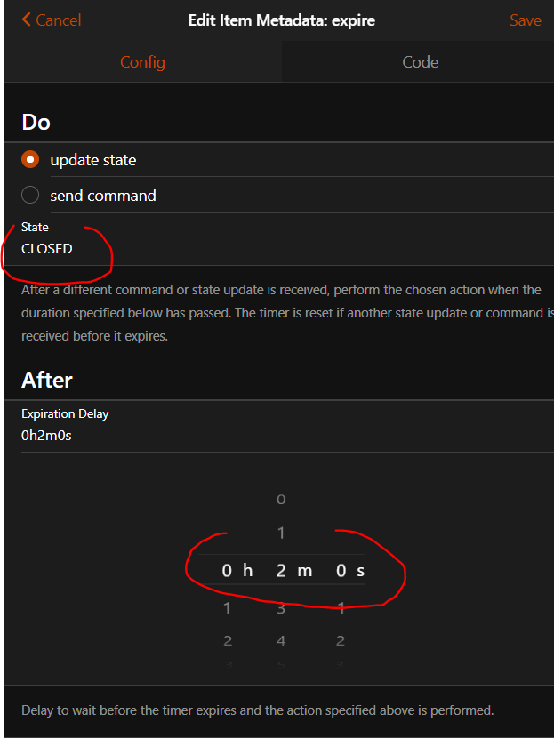

Finally, we attach expire metadata to the presence item and adjust the timeout to our needs:
This solution neither needs a proxy item nor a rule. :wink:
