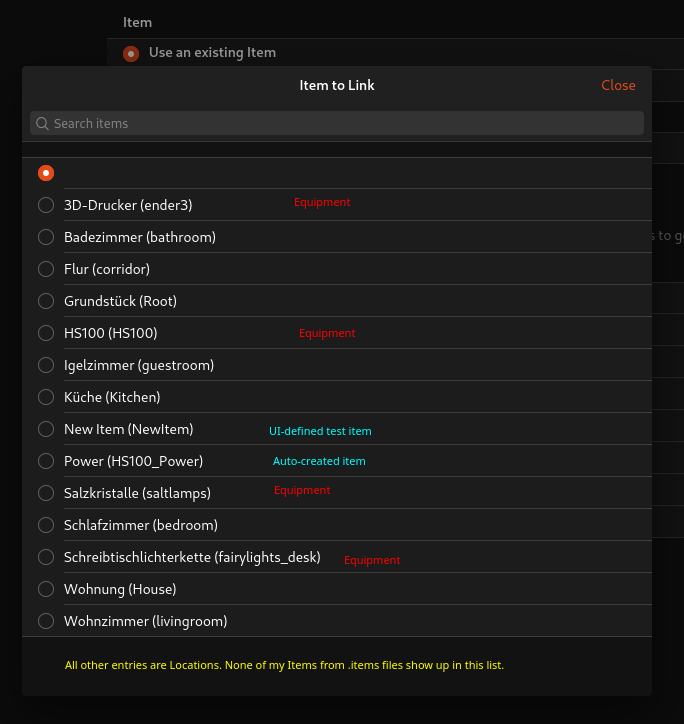

I tried the same approach again, but I can’t seem to link my textually defined items to channels in OH3. I navigated to Things > [some Thing] > Channels > [some Channel] > Add Link to Item, selected Use existing Item and clicked Item to link, only UI-defined Items show up in the list. All textually defined Items are missing. However, all of them are there when I click on Items on the left sidebar.
Of course, I double-checked that both the channel and the Item I’m trying to link have the same type (Switch in this case). But that probably doesn’t matter anyway because I can link all the Locations and Equipments I created just fine. (Are there even any scenarios were that makes sense?)
I created an additional Switch type Item in the UI for testing and I can link that just fine, but I’d rather keep using my item files. Also it doesn’t seem to matter where the Thing in question was defined. I also tried multiple Things and Channels, but text-based Items didn’t show up once.

You seem to be describing a different problem. I recommend you create your own thread for that.
That being said, your Items file looks fine to me. Have you made sure that the Channel and the Thing actually exist? You said that you started from scratch, so it might have gotten a different ID, or maybe you just forgot to add it. I recently had problems with the Astro trigger channels but it turned out I had simply forgotten to add the local sun as a Thing.
