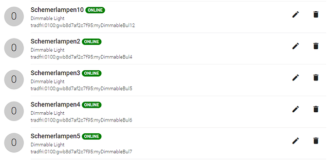

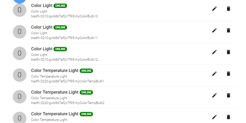

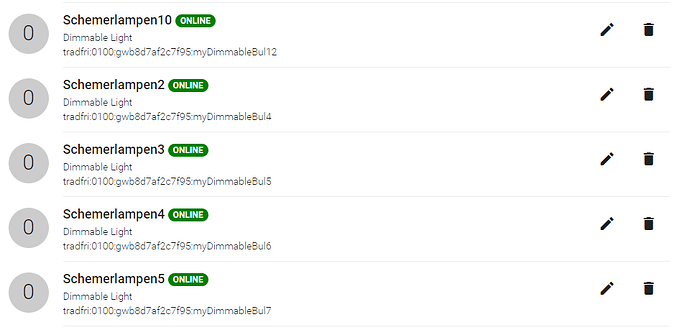

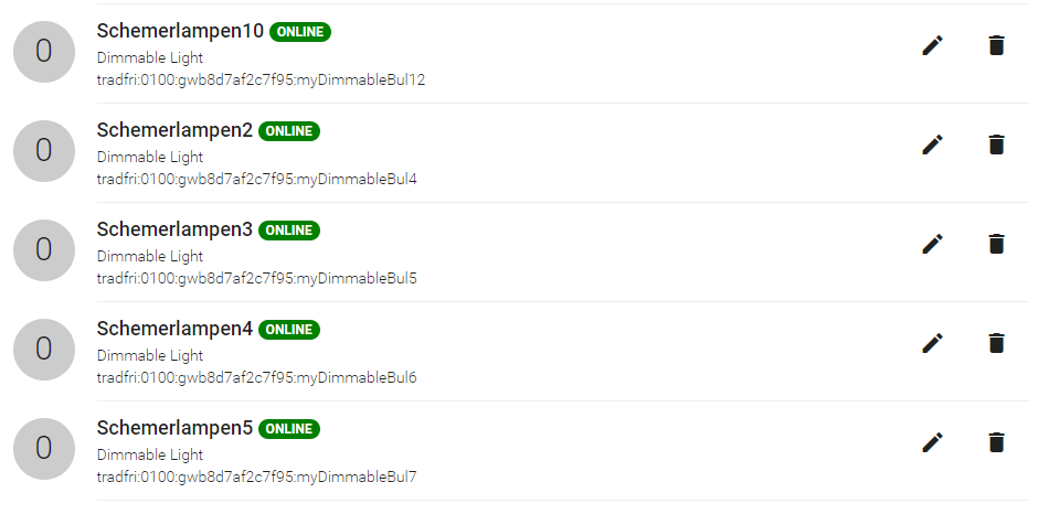

but in PaperUI is see everything seperated like this:

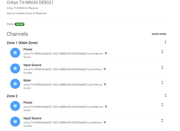

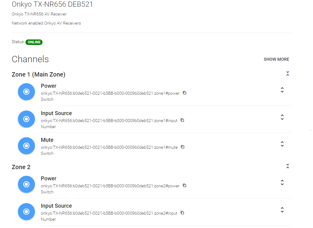

I was expecting to have one Thing with everything linked to a diferent channel like this one:
