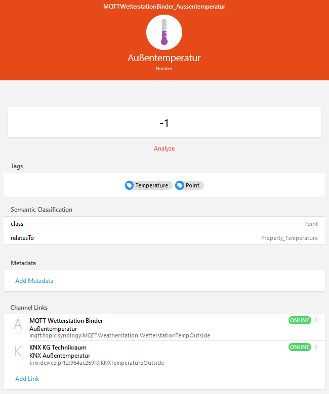

Thanks a lot! After activating the “postCommand” (called Is Command in the “show advanced” GUI), it works:
grafik
