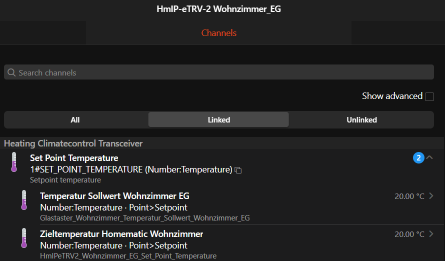

So far I’ve only been using the latest version of openHAB to visualize and automate my KNX system (MDT). Now I would like to add Homematic IP and also be able to control the setpoint temperature of the Homematic IP radiator thermostats via my MDT Glastastaster 2 Smart. To do this, I have created a channel for each of the two Things (MDT push-button / Homematic radiator thermostat) and added the two items of type Setpoint (Temperature).
If I now change one of the setpoint values within OH, this is also transferred correctly to the other IT and the correct desired temperature is displayed on both the glass push-button (KNX) and the thermostat (Homematic IP). However, if I change the value directly from the thermostat or glass push-button, this is also displayed and transmitted correctly in OH, but the value is not transmitted to the respective opposite side. So if I change the value via the glass button, it does not change on the thermostat, and vice versa.
What am I doing wrong? Do I need a rule or a script to transfer the values?
How are these channels linked to items? Are you using any profiles or rules?
Thanks for your answer!
At the moment there are 2 channels (1 x KNX, 1 x Homematic) each with 2 items linked. The items are configured with the standard profile and no rules are in place. I’ve tried the “follow” profile but it didnt change anything.
Please post the KNX thing config

bridgeUID: homematic:bridge:5595f3cd5f
(there are channels, dont know why they are not in the code?)
label: Zieltemperatur Homematic Wohnzimmer
type: Number:Temperature
category: Temperature
groupNames:
  - Wohnzimmer
groupType: None
function: null
tags:
  - Temperature
  - Setpoint
label: Temperatur Sollwert Wohnzimmer EG
category: temperature
groupNames:
  - Wohnzimmer
groupType: None
function: null
tags:
  - Temperature
  - Setpoint
OK, so you’ve two independent Channels each linked to their own independent Item (2 Channels, 2 Items).
You want them to remain in sync.
Because this is a two way sync, you’ll probably need a proxy Item and a rule. The Proxy Item is the single Item that OH uses to represent this thermostat.
When one of either of your exiting Items changes or the Proxy Item receives a command, trigger a rule. In this rule, command the other Item to the new state and update the proxy Item as necessary. Only command the Item if it’s not already in the new state. Disable autouptate on all three Items.
That should eliminate infinite loops and keep the two Items in sync.
The follow profile often works in cases where one of the devices is in charge and the second device always follows. If changes to both devices need to be synced then you have to use a rule.
