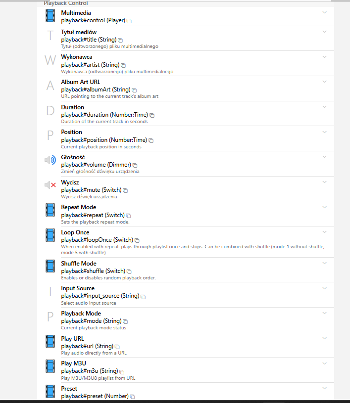

The album channel is not available, it was available on first version, but now is not. In trace log I have:
2025-02-16 10:49:21.409 [DEBUG] [nternal.handler.LinkPlayThingHandler] - Channel not found with group prefix: playback#album

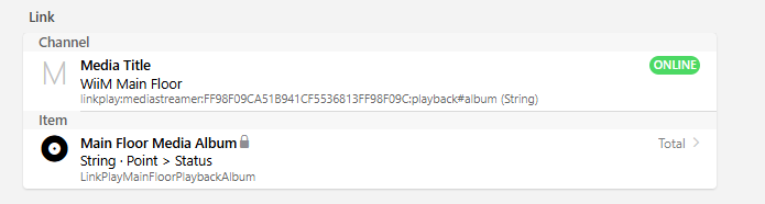

Strange - here is my Album item. Maybe delete the thing and try again? Confirm you are using the right channel (note: I had to change the XML for the channel).
Hi, I deleted all items, deleted thing, remove jar file, reboot openhab, add jar file again and add thing again and Album channel is missing.
