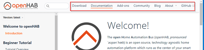

I have already created an issue for a problem on the documentation website:
opened 04:29PM - 30 Dec 20 UTC
closed 11:24PM - 04 Jan 21 UTC
Feedback
Steps to reproduce:
- open https://www.openhab.org/docs
- click on "Download… "
You can now see a small progress bar on the top of the window, but the links is not opened. If you click on the link with the right mouse button and open the link in a new tab or window, it works.

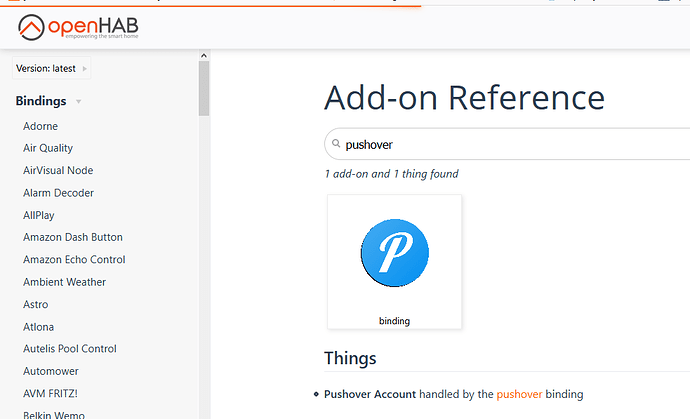

The same problem occurs in the Add-ons documentation if you try to click on one the products in the left sidebar.
I have tested it with Chrome, Edge and Firefox. Always the same behaviour.

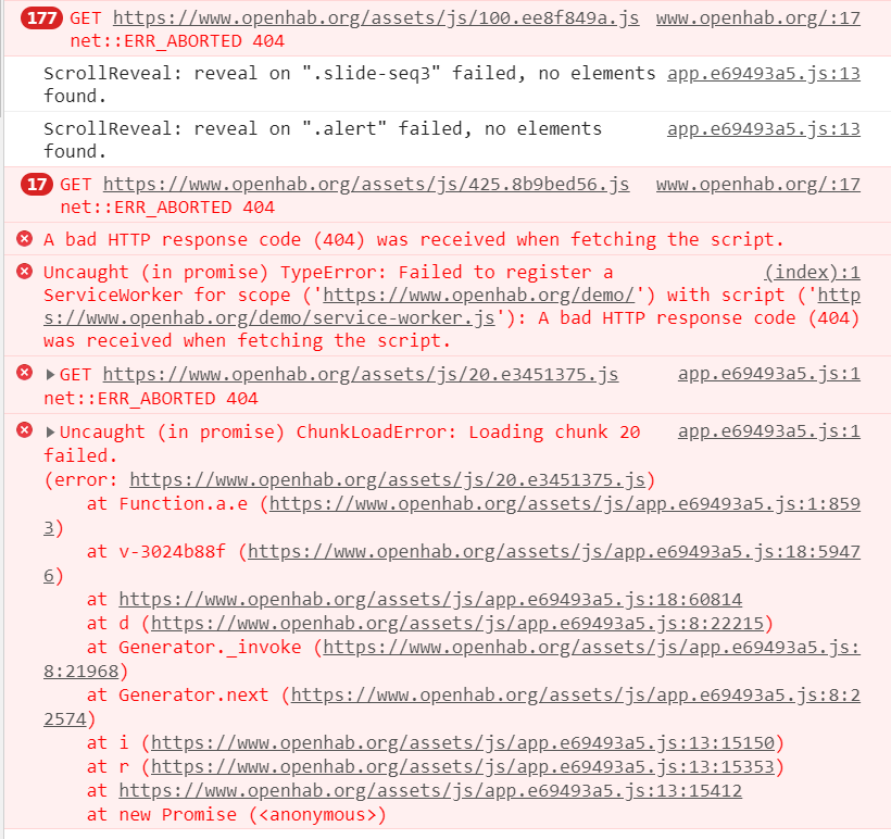

In the console of the developer tools, I see these error messages:
The last message is issued if you click on one of the links.
There is the same problem on the main website, e.g. on www.openhab.org the links in the top bar (e.g. “Download” are not working. The console shows these error messages:

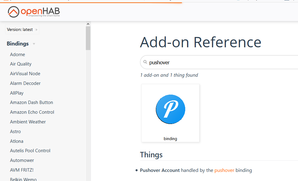

There are also problems with loading some of the docs:
