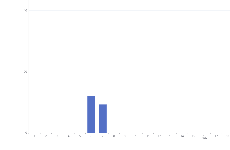

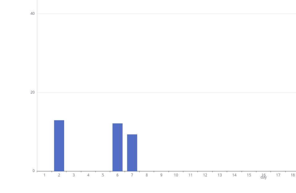

I tried to display the consumption values from the linky binding for each day of a particular month. However, the chart displays the values incorrectly: the value displayed for a particular day is in fact the value for the day before. This is normal since I used an item bound to the daily#yesterday channel. I have thus the following chart (I made this test today).
I have modified the configuration of the chart to add an offset to the time series in order to shift by one day:
 series:
    - component: oh-aggregate-series
        aggregationFunction: last
        dimension1: date
        gridIndex: 0
        item: Linky_ConsommationHier
        stack: total
        type: bar
        xAxisIndex: 0
        yAxisIndex: 0
        offsetUnit: day
        offsetAmount: 1
However, I have the following result:
Day 2 disappeared although it should be displayed on day 1. Moreover day 6 and 7 did not shift by one day.
Did I made a mistake in the configuration ?
