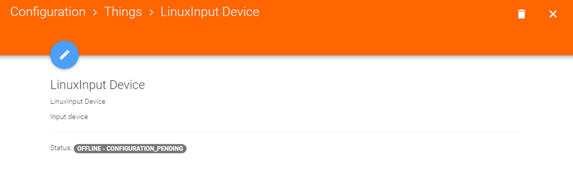

I would like to use an USB Keyboard connected to RPi 4 to implement Linux input binding
But when I add the path, the status is offline.
I tried adding the path in three ways

Yes, but I dont know how to give openhab, rights to access /dev/input files.
Can you please help me to configure the Udev rules in linux
