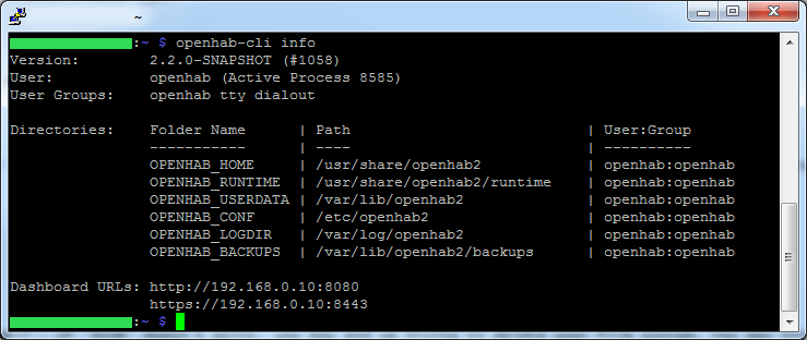

Of particular use is the openhab-cli info command, which gives a list of common properties and what they’re set to in-order to help resolve a problem!

You can see all openHAB related variables and what they’re set to using:
printenv | grep "OPENHAB_"
