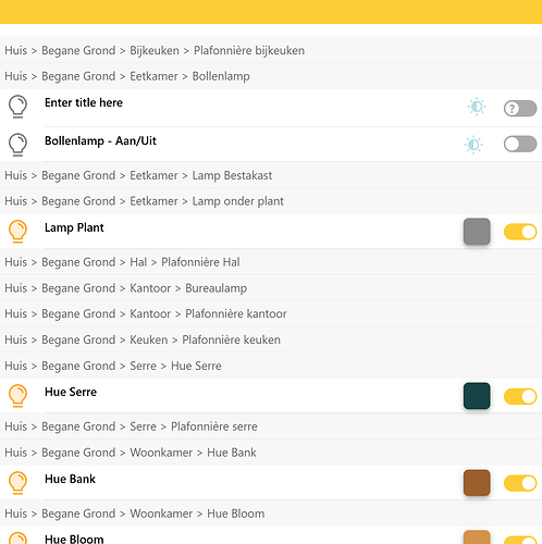

I’ve recently updated my installation from 5.1.1 to 5.1.2 and suddenly the list items with a simple custom list widget does not display anymore. The listwidget does show in the widgeteditor page. Does anyone have a clue where to start researching? I didn’t see anything in the release notes that hints me to the right direction….
The widget is a simple widget, that only changes icon and colors:

See this example in my “Equipment Tab" / “Light Bulbs”:

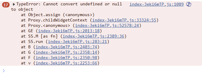

Which browser are you using and do you see any errors in the browser console when you open an equipment card?
I’m using Edge and the Android App, neither of them shows the items. The browser console throws an error when I open the Lightbulb card (but this is abracadabra for me):
No worries, it’s not very meaningful for most and doesn’t really need to be. The good news is, it is enough to: 1) demonstrate that this is a bug, so an Issue should be filed (I can do that), and 2) suggest a work around until a bug-fix is applied.

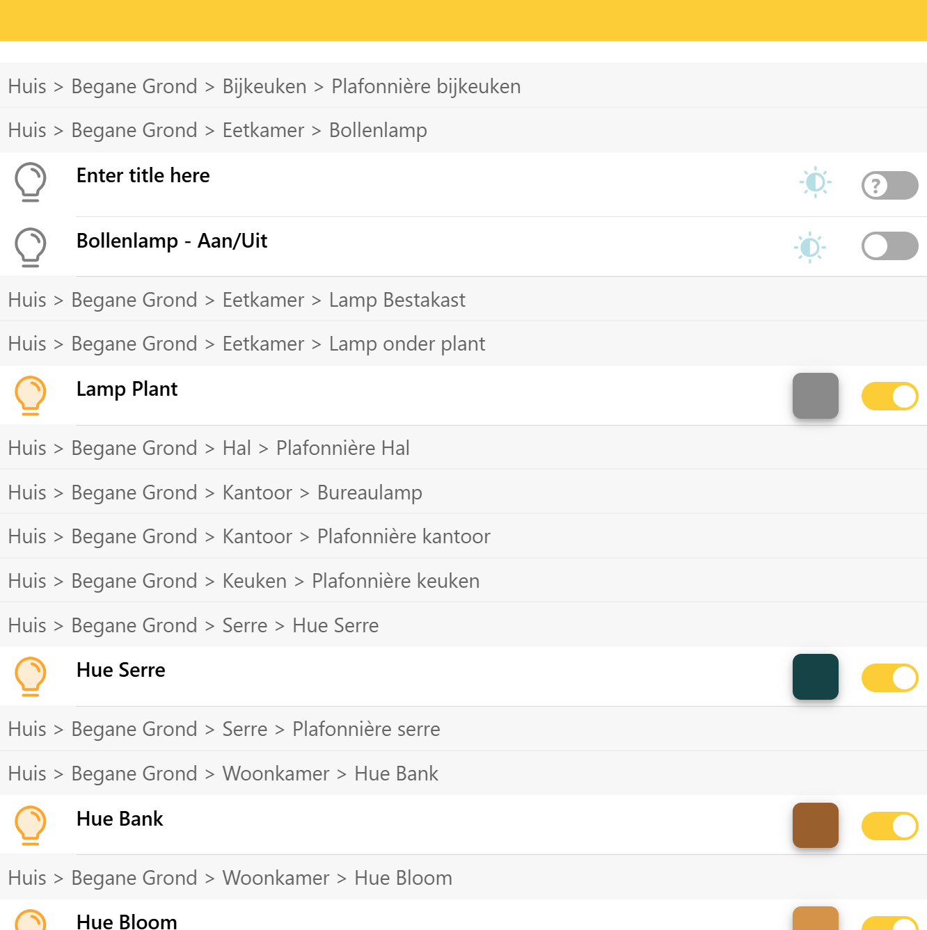

All you need to do is add slots: {} to the end of your widget:
uid: light_list_widget
tags:
  - light
  - list
props:
  parameters:
    - description: The label for the widget
      label: Title
      required: false
      type: TEXT
    - context: item
      description: The light switch Item
      label: Item
      required: false
      type: TEXT
  parameterGroups: []
timestamp: Aug 13, 2024, 8:43:41 AM
component: oh-toggle-item
  color: '=(@@props.item == "ON") ? "yellow" : "gray"'
  icon: '=(@@props.item == "ON") ? "iconify:ph:lightbulb-duotone" :
    "iconify:ph:lightbulb"'
  iconColor: '=(@@props.item == "ON") ? "orange" : "gray"'
  item: =props.item
  title: =props.title
slots: {}
and your widgets should appear in the model cards again.
FYI:
Jeez. You are a wizzard! :joy: I’ve done my fair share of debugging in the past, but I would have never found this one myself, just based on that error message.
Thanks Justin! I can confirm my widgets are visible again (and more important: the imminent divorce has been avoided :innocent: )
