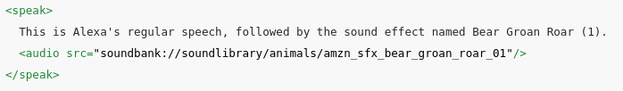

  • I’m not 100% sure yet on the usage of the items in that Amazon-list. The example mentions in the article (soundbank://soundlibrary/animals/amzn_sfx_bear_groan_roar_01), dows not work if being used like this in openHAB…
events.sendCommand('Echo_Bad_AlarmSound', 'soundbank://soundlibrary/animals/amzn_sfx_bear_groan_roar_01');
and using it like this…
events.sendCommand('Echo_Bad_AlarmSound', 'amzn_sfx_bear_groan_roar_01');
plays the normal “system_alerts_repetitive01”-sound (so some interpretation is going on in the background).
Am I misunderstanding something here?

  2. In order to use the sounds listed here Alexa Skills Kit Sound Library | Alexa Skills Kit they have to be sent to to .textToSpeech in the following syntax.
    Example:
    events.sendCommand("Echo_Bad_Speak", '<speak>Alarm! <audio src="soundbank://soundlibrary/scifi/amzn_sfx_scifi_alarm_06"/></speak>');

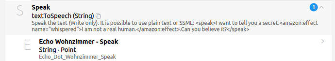

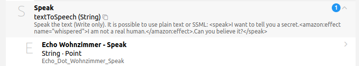

Below what has always worked for me:
Link between Thing and Item:
Test rule (javascript):
events.sendCommand('Echo_Dot_Wohnzimmer_Speak', '<speak>Test<audio src="soundbank://soundlibrary/scifi/amzn_sfx_scifi_alarm_06"/>Test</speak>');
