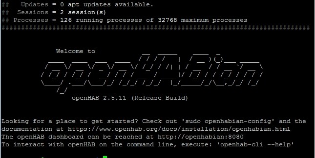

In a separate dialog i was told to use xxxx.2.5.12-snapshot.jar how can I go to 2.5.12 snapshot version from 2.5.11?
With openhabian I tried with
01 | Select Branch
* master
and
40 | openHAB Related
41 openHAB snapshot Install or switch to the latest openHAB SNAPSHOT build
Unfortunatly it is always shown
openHAB 2.5.11 Release Build
in WEB and in SSH Terminal

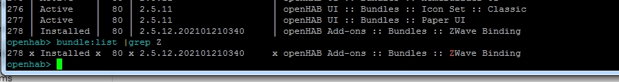

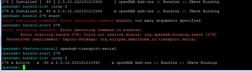

tried to use the snapshot jar file as sugested above…
result:
What caus this*?
Cheers
S
solution …
Than
delete “Z-Wave Serial Controller”
and “add Z-Wave Serial Controller” again
in UI (don´t forget to use the old “Thing ID”
