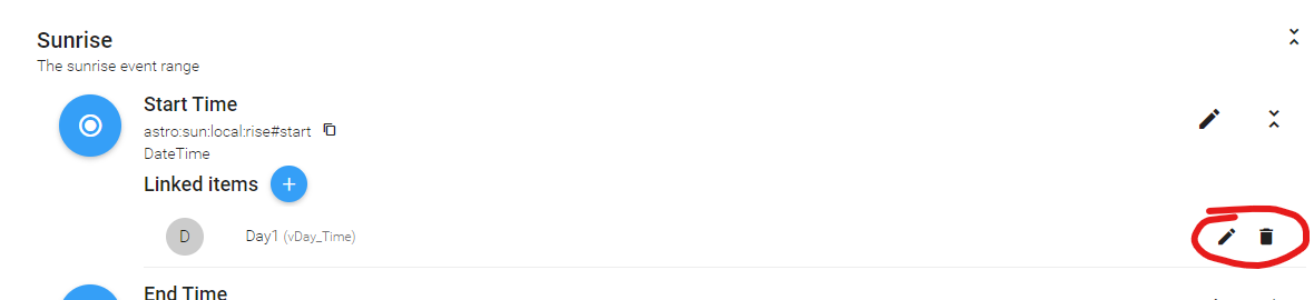

Note I just removed a couple additional hue bulbs and this time I know I deleted the item, but PaperUI re-loaded after I hit the trash can next to the item and the item was back without a trash can. What is going on?
Always remove the Link before removing the Item. There is apparently a problem in PaperUI that is leaving the Link. As long as the Item appears in the Link file it will appear in the Item list.

What does this mean? I thought the item in the PaperUI was the link. There is no section in PaperUI for links. I deleted the item first, then the thing. Is there something else I should have done first?

Before you delete a Thing, go to all of the Channels and remove any Links to Items before deleting the Thing. Otherwise you end up with orphaned Links.
