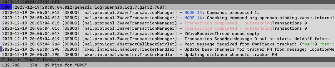

An impression of how it looks, with two patterns marked:

In the screendump, you see openhab.log output and events.log output in one view :
Here, a line from openhab.log and events.log are marked (black background).

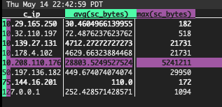

The way you can use sql command to create reports is impressive, although I cannot find an easy use case for openhab users:
