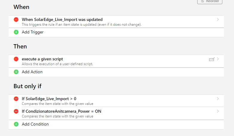

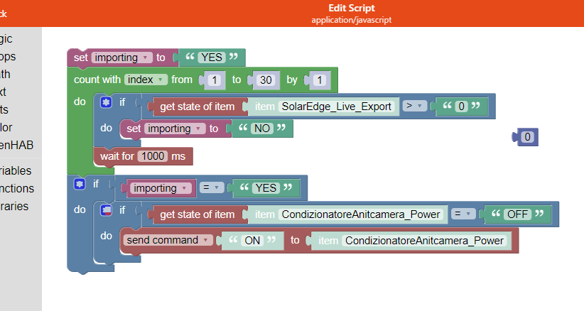

This work as expected, but after some days of use I found out a thing I didn’t considered.
There’s a lot of situation that can cause the air conditioner turn off and on repeatedly, for example in a partially cloudy day where solar panels production can vary a lot during the day.
Or also when turning on high comsumption appliance for few time (for example a microwave for 30 seconds).
I want to avoid turn off units just for 30 seconds or less.
I already thought of increasing the 5 seconds interval to something more like 1 minute, but it’s not the solution, because also if the rule it’s less frequent, it could happen that it run during a very short period where the production of the panels is low, causing an unnecessary shutdown.
Instead of checking the value in that moment, there’s a way to check if the value kept a value greater than 0 for a certain period (for example 5 minutes), and after that time turn of the conditioners??
