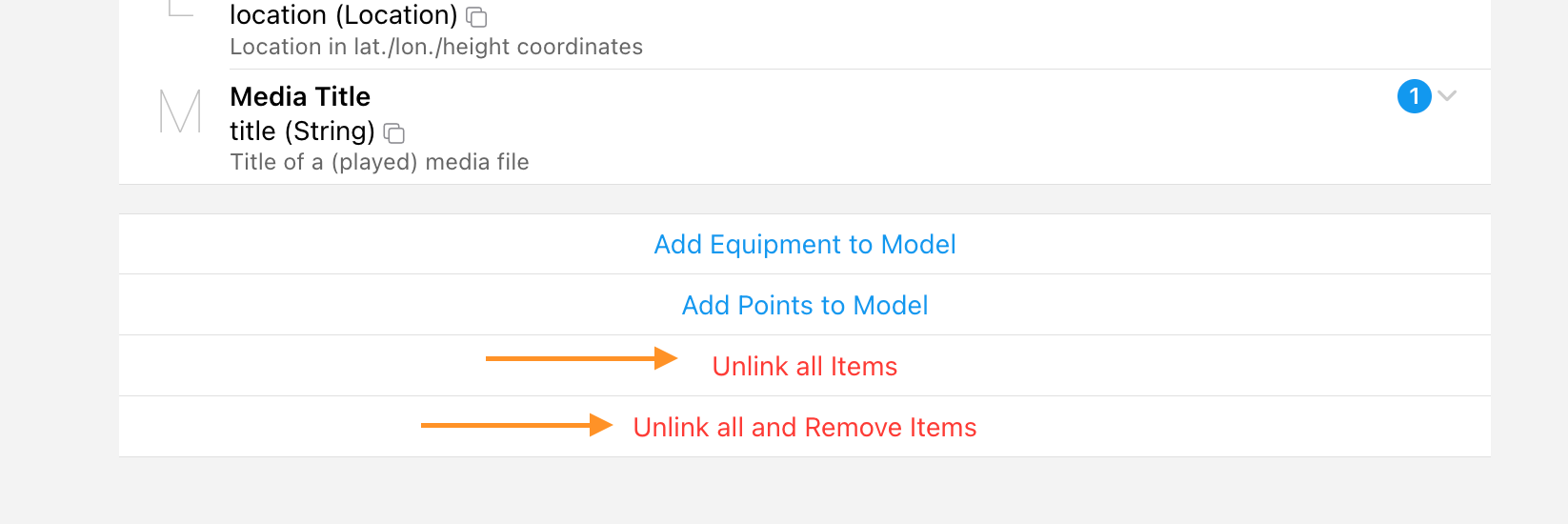

So to “rename” an Item in the UI you need to do the same thing. Delete the Item and recreate it. To delete you can delete the link and the Items linked to a Thing’s Channel from the Things page or the Link page. When the Item is deleted this way my understanding is that the metadata registry will clean itself up as well (I don’t think managed Item metadata gets cleaned up at all for text based Items). You can choose to remove the link or not but you should.
From a bulk edit perspective, you can do this for all the Items linked to a Thing all at once using the options at the bottom of the Things Channels page.
Then you can use the “Add Equipment to Model” or “Add Points to Model” and you can recreate all those Items in one go with the new settings/names/etc. What’s nice about this is not only can you crate and configure all the Items for that Thing in one go, there are reasonable defaults for a lot of things and it will create the Equipment Group for you and let you select the Location.
But whether you are doing this in a text file or through the UI, renaming an Item should be done with great care. Not only will you potentially need to update rules and sitemaps and such but you will disconnect that Item from its persistence and it’s metadata. Renaming an Item should not be taken on lightly. I personally think it’s too easy to do so in .items files but not enough to harp on it. But it is a source of “leaks” in openHAB because by design not everything gets cleaned up on the unload/reload.

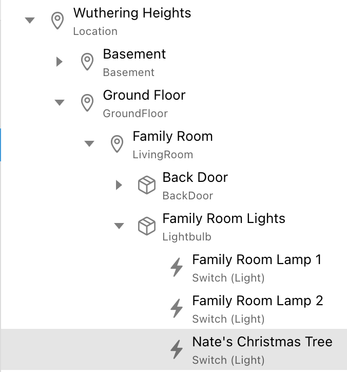

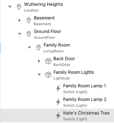

I find using meaningful names and the location fields are more than sufficient when combined with the binding and the channels to determine what a Thing is for and what it represents.
Items
Here too, the Item name, label, type, link, Group membership, semantic tags and position in the semantic model, and additional tags make it clear what the Item represents and what it’s for. Were I to need more, I’d probably use Item metadata to capture some notes.
For example:
It’s pretty clear that Nate’ Christmas Tree controls the lights of a tree in the Family Room. Notice the Item name doesn’t even appear in this tree (you can click on it and get the Item name easily enough though if you need it).
