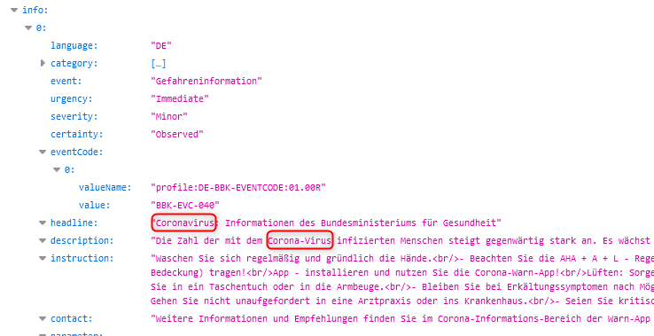

one thing is, that there’s no instance ov “Covid”, but “Corona” and then it’s only in the descriptive texts, and then also there’s different spellings:
grafik
So, you could search for “Corona” and drop the information also. I’d like to have all warnings sorted out, if like e.g. the local government decides for new means for containing the spread.
