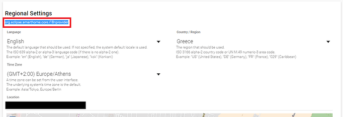

PaperUI → Configuration → System → Regional Settings references only the newer (i18n) stuff:
