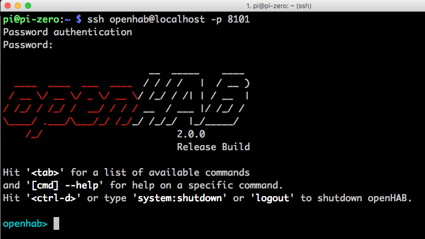

You have to run the START.bat file in the OpenHab directory…it will pop open a black window which must remain open to use OH. Once it’s open and you see something like the following window you can then launch a browser and try and connect to the localhost address:
